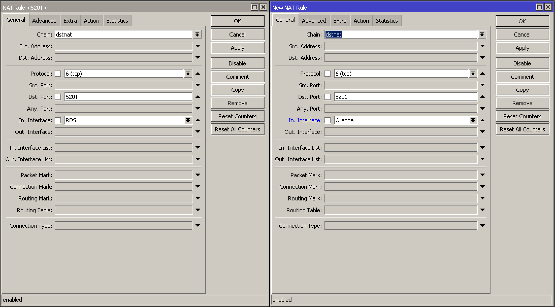

I have two ISPs, WAN1 RDS (which is my default ISP on ether1), WAN2 (Orange, which was installed later on, ether2)
I want to expose port 5201 (iperf3) also on WAN2 (Orange) the problem is that when trying the public IP with telnet on port 5201 it is not reachable and I don’t know why.
Moreover the same port is already exposed on WAN1 (RDS) and it is working without any issues.
Somehow, I think that I am missing something.
Please see my screenshots attachments.

If you have two gateway, only one at the time is used
about nothing of your routing are know,
simply your reply still go trough RDS, not Orange

(5) One destination NAT rule is different from the others… LOL Without some matching config setup its not going to accomplish too much.
add action=dst-nat chain=dstnat comment=“IPERF3 Orange” dst-port=5201
in-interface=Orange protocol=tcp to-addresses=192.168.2.10 to-ports=5201

Going back to the original issue - as there is no connection and routing marking the incoming traffic from either WAN will return via the default route through WAN1, so likely fail for WAN2. The WAN2 connection traffic should be marked and have an additional routing table to return the marked traffic via that WAN.
