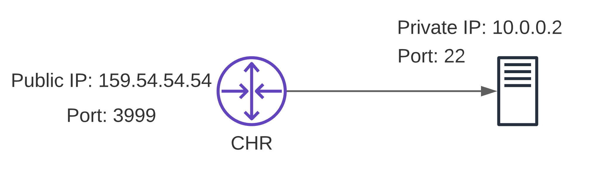

I just installed the CHR and trying to do a port forward from the WAN IP to a Private IP on port 22. Here’s a diagram that explains the setup. Also, I want only a specific IP to be able to establish that connection using that external port. To my understanding, I need to create: a) a NAT rule b) a Firewall rule to allow that particular external IP to connect.

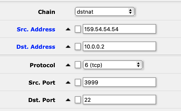

So far what I’ve tried, even without the firewall rule as to just to get the port forward to work, the port appears to be closed in the port checker tool. I will appreciate all the help.
If I need to post my Log, then please let me know the commands to get it as I’ve just used the webfig to do the configuration. Thank You.
You should be using the Action tab for selecting the destination:
add action=dst-nat chain=dstnat comment="SSH server" dst-address=159.54.54.54 dst-port=3999 protocol=tcp src-address=[fill in the allowed IP address] to-addresses=10.0.0.2 to-ports=22
Thank you. Now I’m getting a connection timeout error when trying to SSH using the Public IP and Port. However, the source IP and the destination IP:3999 does show up in the “Connections” momentarily and then disappears.
I’m able to Ping the destination private IP using the Router CLI. The port checker still shows 159.54.54.54 port 3999 as being closed.

on the graph is missing what IP have the CHR on server side
supposing CHR can ping 10.0.0.2 (test!)
and have IP 10.0.0.1 (/24?) on server side
paste this on terminal and retry:
remove [find where comment="SSH server"]
add action=dst-nat chain=dstnat comment="NAT SSH" dst-address=159.54.54.54 dst-port=3999 protocol=tcp to-addresses=10.0.0.2 to-ports=22
add action=src-nat chain=srcnat comment="reverse path SSH" dst-address=10.0.0.2 to-addresses=10.0.0.1

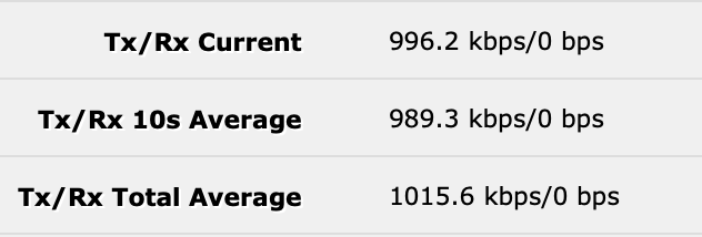

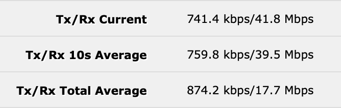

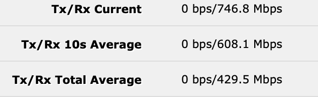

One thing I noticed that the data rates are very very slow, at most 1 Mbps. For eg. for testing, I port forwarded to a Samba Share on the same IP and a 10MB file takes about 3 minutes to transfer to a Client PC.
The Samba Server has a 20Mbps upload speed. Mikrotik Router Bandwidth Test on IP 23.162.144.120 yielded some interesting results. I did two tests, one only receive, and the other using “both” option (send and receive), both tests TCP. Here’re the findings. What should I be testing? I thought maybe there was a reverse NAT issue causing the slowdown but from the tests looks like it is the transmit speed? Is there anything within CHR that could be causing this? CHR is running on a dedicated server, and there’s nothing else running as this is a test setup.
Receive Only Test:
Send Only Test:
Send/Receive Test:
I fixed the bandwidth tool speed by upgrading to a CHR P1 license, totally forgot about the 1Mbps limit and now the bandwidth test tool speeds are as they should be- Fast. However, accessing the port forwarded services still has latency and then it picks up eventually once it’s connected. Could it be due to NAT/Reverse NAT?
