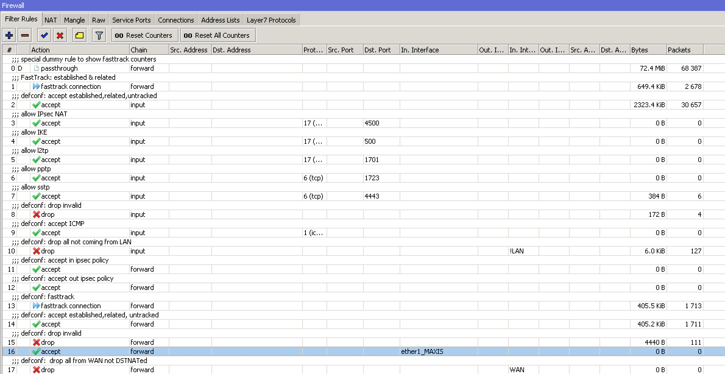

As per attachment is the screenshot of firewall rules. It show that I has been add in the new rules. unfortunately, it still unable to access from public

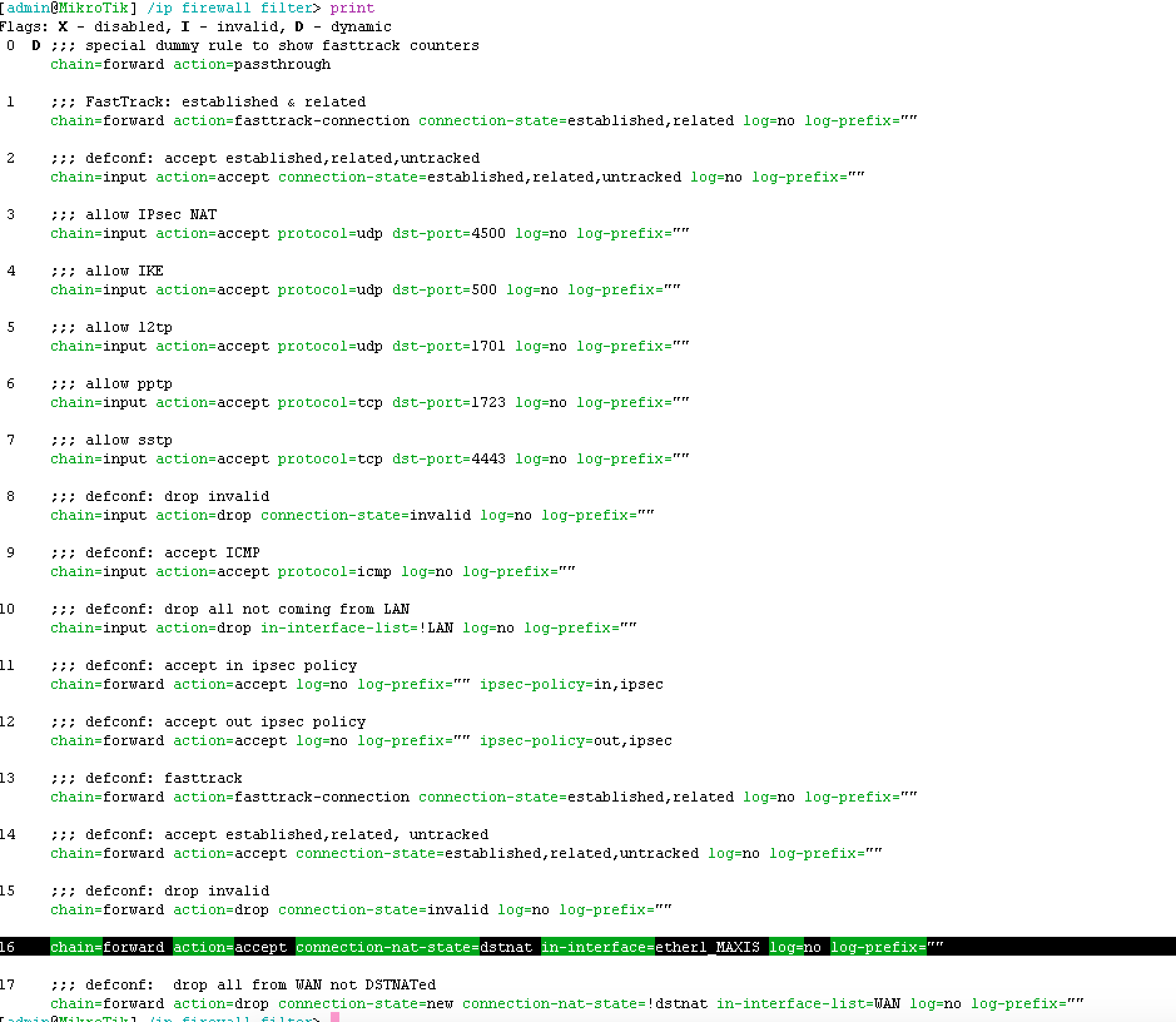

as per attachment is the screenshot from terminal. Kindly review
As I see now your default rule 17 does the same, so you don’t need the one I suggested at all.
