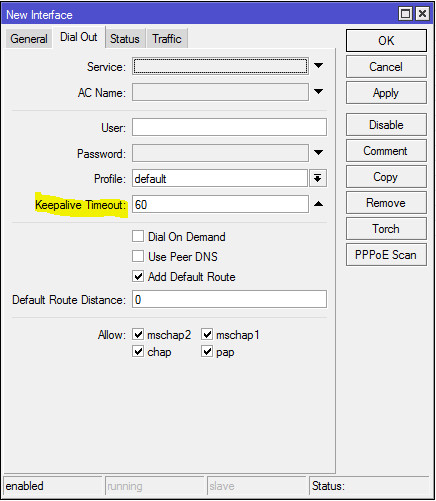

I have not much experience with PPP connections however if you suspect an issue with the Keepalive did you try setting the Keepalive Timeout higher?
The connections were made permanent so I’m not sure why its even sending the request.
