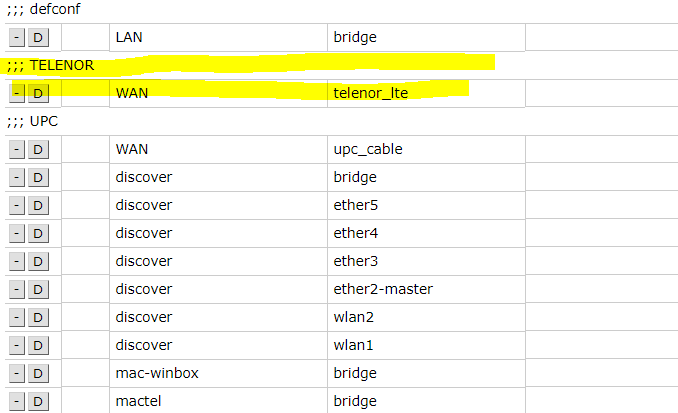

I see the following screenshot in another browser window after I enable the ppp-out1 interface (called telenor_lte here)
the yellow lines unluckily disappear after 1 second, or even faster, so it was difficult to catch this very moment
If i have no default route on my ppp-out interface i cannot use my telenor_lte 3g usb stick as a failover WAN for my UPC modem

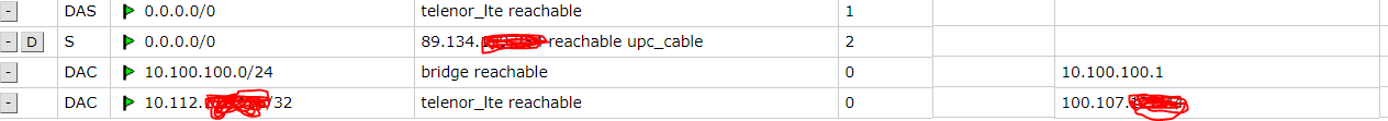

But, there is still an issue
I have Distance 1 on the LTE when LTE is enabled I can ping 8.8.8.8 from the Mikrotik
But i cannot browse the internet from a DHCP client (laptop) behind the router
I have Distance 2 on the UPC and everything works there when LTE is disabled
Is that because of the Distance 0 below? or what is that Distance 0 if PPP is enabled i dont understand that line

That’s two unrelated things.
Distance 0 is set on all routes to “connected subnets”, i.e. to all subnets which are accessible directly, without any gateway. But the dst-address of these routes is always just the connected subnet, i.e. its mask is always longer than a /0.
As for impossibility to access internet from LAN via LTE - there may be a missing masquerade rule for the LTE interface, or there may be something else in your configuration - see the “because” above.

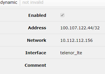

I do do not really understand how can the IP Address 100.107.122.44 be inside the network 10.112.112.156
according to my knowledge that is some strange information that might be the ppp-client that i do not understand
the public IP seems a normal IP

The address assigned internally to the SIM is from the “shared” range (RFC6598), 100.64.0.0/10, so it is not a public one.
It is, however, possible that there is a 1:1 NAT provided by the ISP, i.e. that whatever comes from the internet to the 176.77… one will be forwarded to your machine. But if you’ve tried the 176.77 in the browser and got nothing, it is not the case.
I’ve given you the mangle rule specially so that you wouldn’t need to disable any of the filter ones and still could see the result (mangle comes before filter for incoming traffic so it handles even packets which the filter will drop later).
The IP address of the local end of the PPP tunnel is not in the same subnet like the IP address of the remote end, but it doesn’t need to be because PPP means Point to Point Protocol, so there is no need to find the MAC address of the gateway by knowing its IP address and first finding the local interface by matching the address to all local subnets, then sending an ARP request out that interface and waiting for an ARP response. Here, the IP address is directly attached to the interface as the only possible remote end. You can also see that the mask of the local address is /32, so there is no subnet around it, no subnet address, no broadcast address etc. This is the same with all kinds of L3 point-to-point tunnels, and under circumstances this can be done over plain Ethernet as well.
Regarding the address itself being not a public one, there are two things to mention:
  • some mobile modems emulate a serial line, so the interface is a ppp-like one as in your case; others emulate an Ethernet card so the Mikrotik attaches a DHCP client to them. The address assignment may differ depending on the mode used, although the assignment from the shared range suggests that it is not the case. Nevertheless, it is worth giving it a try - you can choose the mode by a RouterOS command if the card supports both, so check whether :put [/port firmware get ignore-directip-modem] doesn’t return true. If it returns false, your modem doesn’t support the Ethernet card emulation mode.
  • some operators providing public addresses on their SIMs require that a dedicated APN name is used in the LTE configuration in order to get the public IP; if you use the standard APN name, you get the standard treatment.
