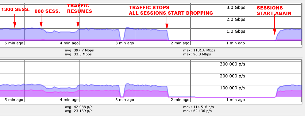

Greetings - we have been having issues with CCRs (including a 1072) dropping all or part of the established PPPoE sessions, during which the CCR appears to stop responding to API/SSH (WebFig remains available but most sections are blank). We contacted Mikrotik with support files etc. and eventually we were told “our hardware is not up to your requirements”, yet our requirements are extremely “light” - PPPoE, NAT/route, rate-limit via simple queues (no OSPF etc.). We have a 1072 in our DC handling 9.5Gbps of traffic with NAT/route from 20 sub-networks, at CPU loads not exceeding 50%.
If you don’t find a fix, I’d suggest looking for an alternative vendor for PPPoE concentrator duties, as we are currently doing. This problem was first reported in 2009 (11 years ago!!) and still has not been fixed. We can reliably reproduce and trigger the problem (if we drop any downstream network segment e.g. reboot a switch or a PtP link), but no fix in sight:
http://forum.mikrotik.com/t/rb1000-closing-tens-of-pppoe-connections-at-once/33500/1
We have tried all sorts of fixes, including raising PPPoE timeout to allow sessions to “survive” a temporary break of a downstream link (e.g. switch reboot as mentioned), to no avail. The traffic from the session comes back, but then all traffic stops while sessions are dropped and re-established:
Above you can see when we reboot a switch, the traffic from ~400 clients drops out, then comes back as if nothing had happened (session timeout 300 seconds on both CCR and CPEs), then the drop takes place about 2 minutes later.

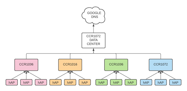

Notice anything odd? Not really, right? Tool->Profile didn’t either, with DNS sitting at less than 1% CPU usage. However, we had hundreds of customer tickets related to “some sites don’t load” and “DNS doesn’t resolve” which in turn caused poor service. We’ve been trying to debug where the issue was for quite some time. We have run packet traces that only show DNS responses sometimes don’t arrive at all, sometimes they come with SERVFAIL, but nothing that signalled performance issues on the CCRs or the network topology. This is our architecture (in terms of configuration, we tried all sorts of changes on the DNS settings of all the boxes involved):
The arrows show who the resolver is upstream for each device. The customer hAPs each also serve as caching DNS servers for the devices connected to them by the customers. Technically, this is quite an efficient setup, as the central CCR will only need to query once (within TTL limits of course) and cache the result for all the network-level CCRs, and the network-level CCRs do the same for the up to 1500 CPEs connected to each one.
The final proof, fed up with coming up with nothing, was to setup a caching bind9 server on a DigitalOcean droplet as a test. We noticed an immediate 15-20% uptick of traffic on two network-level CCRs which had this DNS server setup as their upstream source.
We then setup a bind9 server next to the 1072 at the DC, and pointed all 20 network-level CCRs to it, noting a jump in aggregate traffic from 8.3Gbps peak time to just over 9.5Gpbs. Customers now report they are fine.
Back to my first graph, there is zero positive impact on CPU from removing DNS duties off the main CCR. The change was made mid-day on Friday.
My BIG question to you now is: can you predict, or failing that, observe directly, when the network-level CCRs will “give up” on DNS, just like they “give up” on PPPoE? Yes, we can then point customer hAPs directly to the bind9 server, but do we need to wait for customers to scream and trash us on social media to notice this? What will be the next feature that the CCRs will “give up” on?

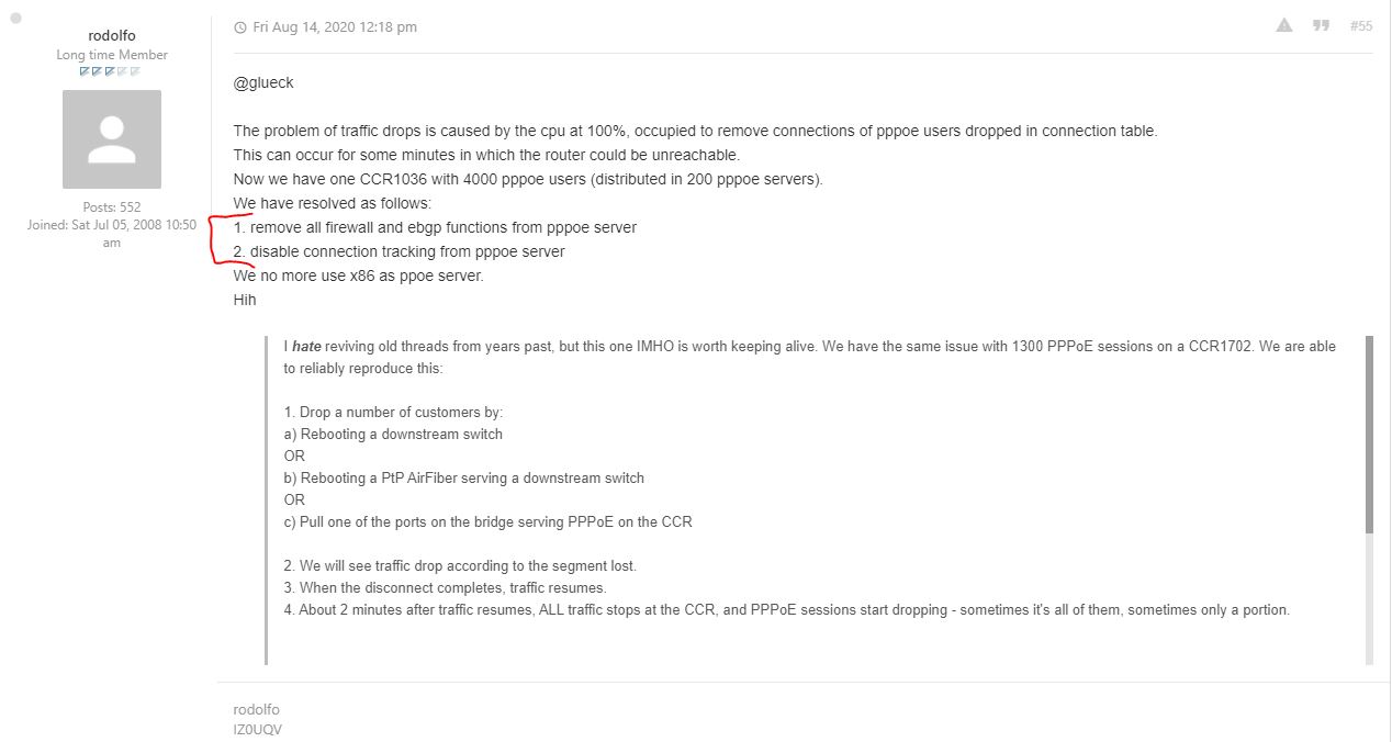

solution is given to you by a fellow Mikrotik Forum member, from topic you quoted earlier
Connection Tracking places a big load on router
Sooooo why is that info not in performance data provided by Mikrotik, alongside DNS resolver capabilities, etc? Why is soooo hard to analyze connection tracking issues? You’re getting to the answer, not the path that it takes to resolve an issue.
