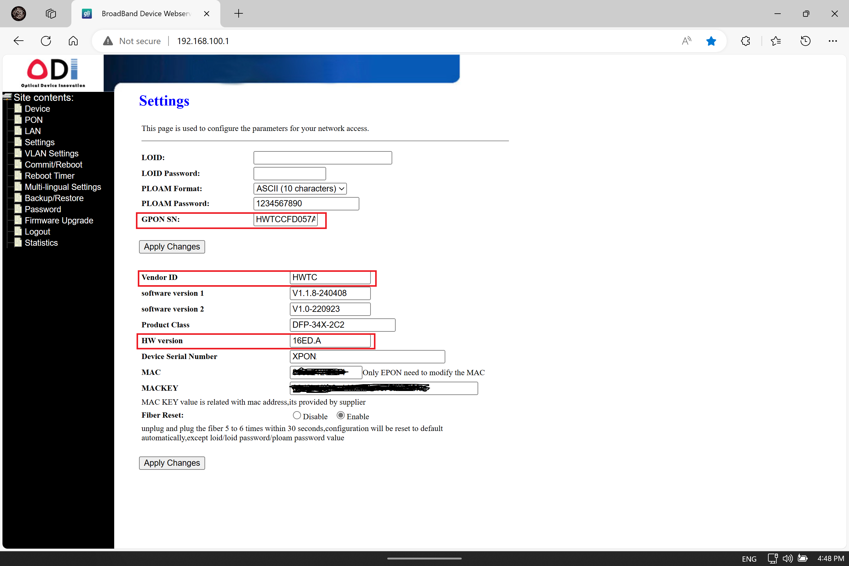

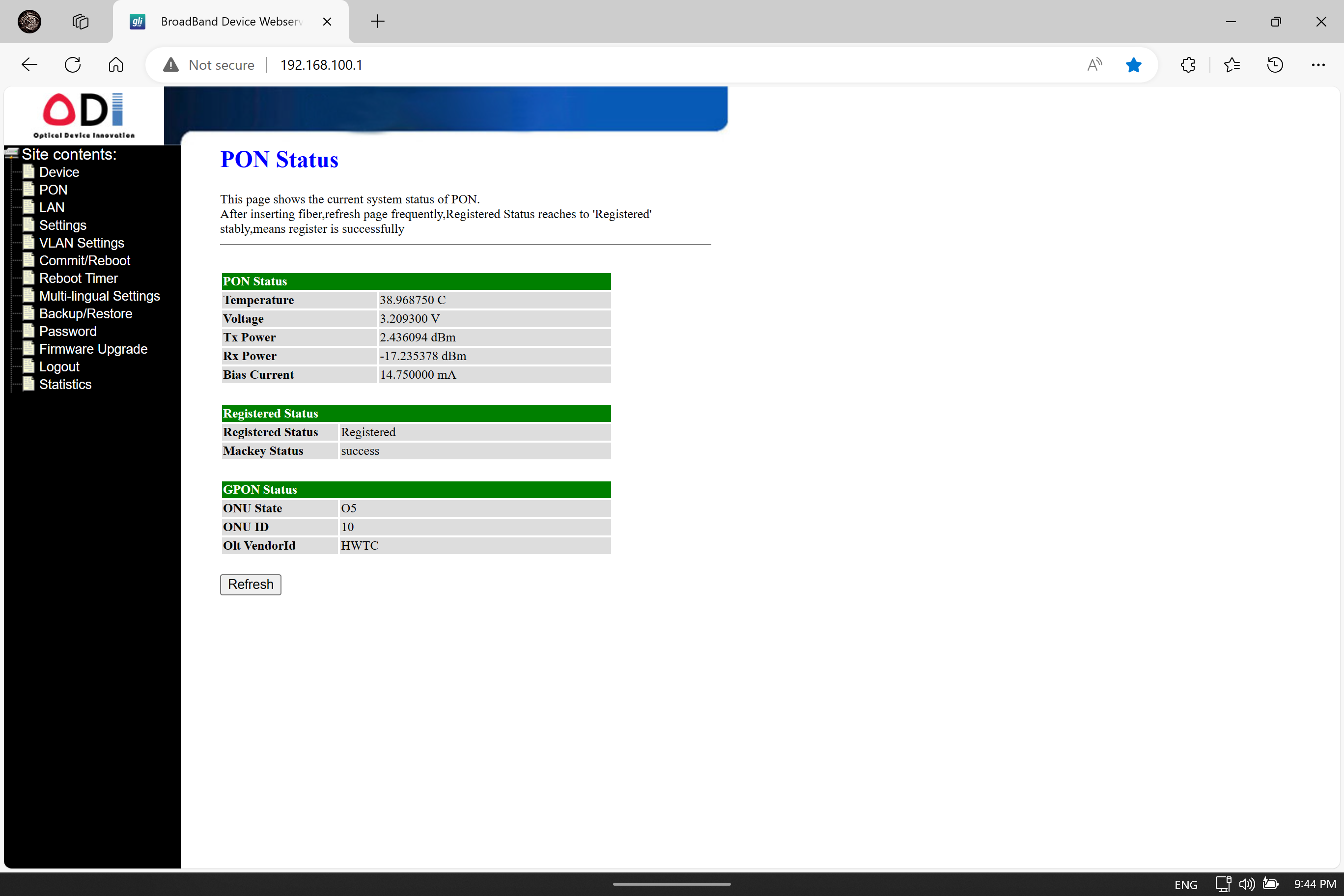

So I just received my ODI GPON ONU SFP today, configured it after updating the Firmware.
I’m getting an O5 state and It says Registered on the GPON Network.

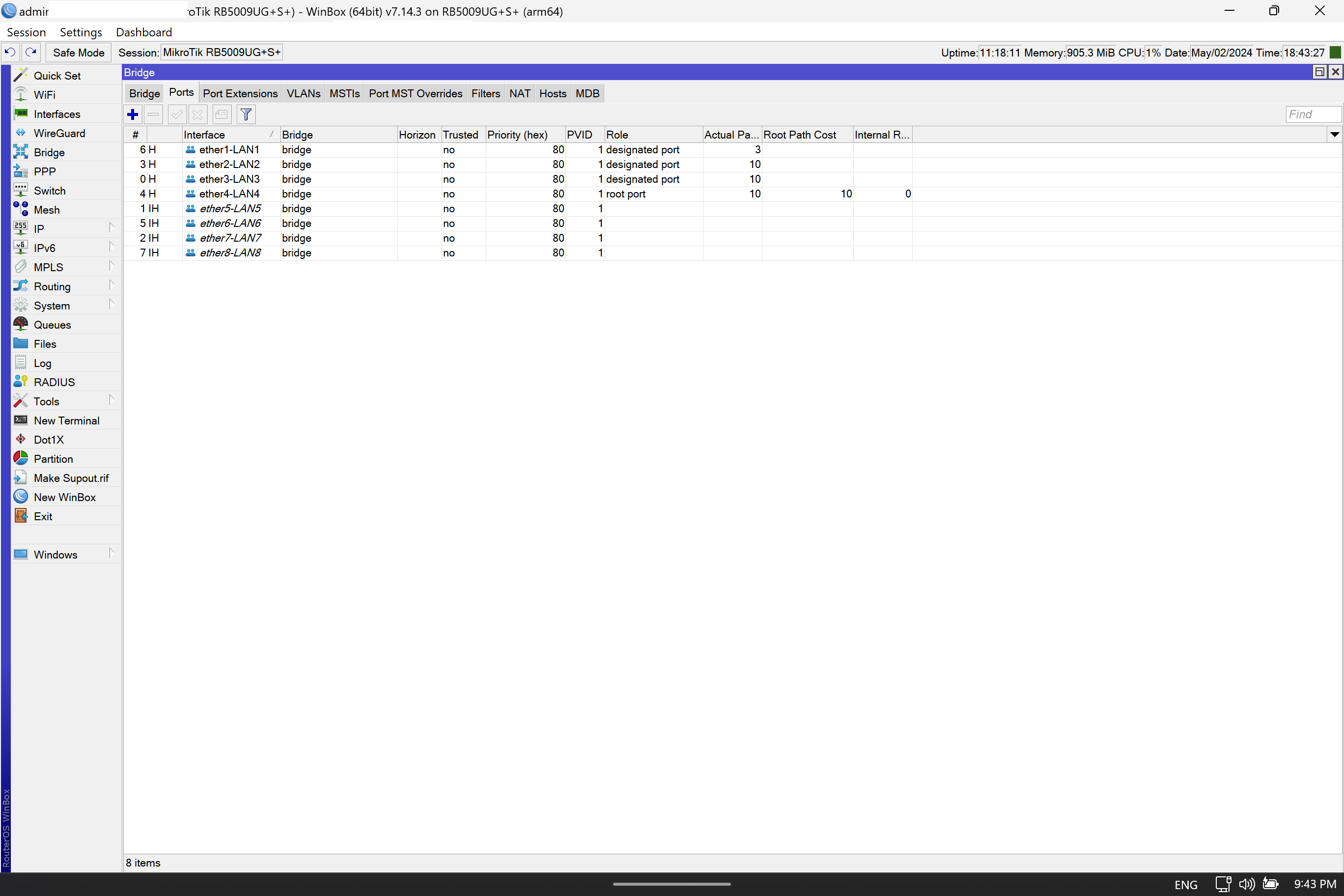

I have also changed the WAN Interface to SFP Port after removing the port from the Bridge as it was a Slave and I still cant get the PPPoE to Scan for the ISP Service.

Here is my Configuration, I tried exactly as yours. But Its not able to initiate the PPPoE Dialup.

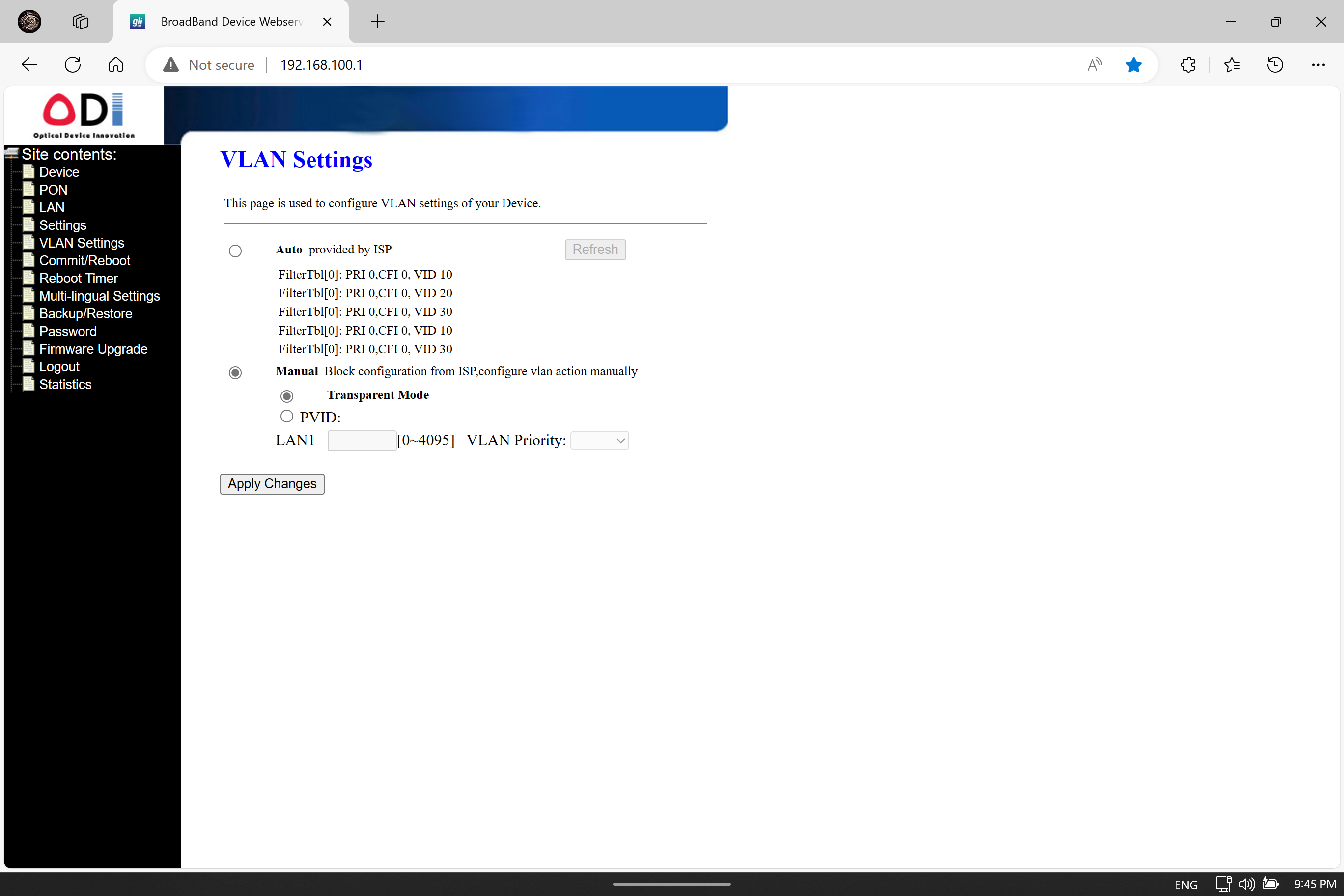

I even set the ODI VLAN to Transparent Mode. (The Auto is detecting the VLAN to 10 as well)

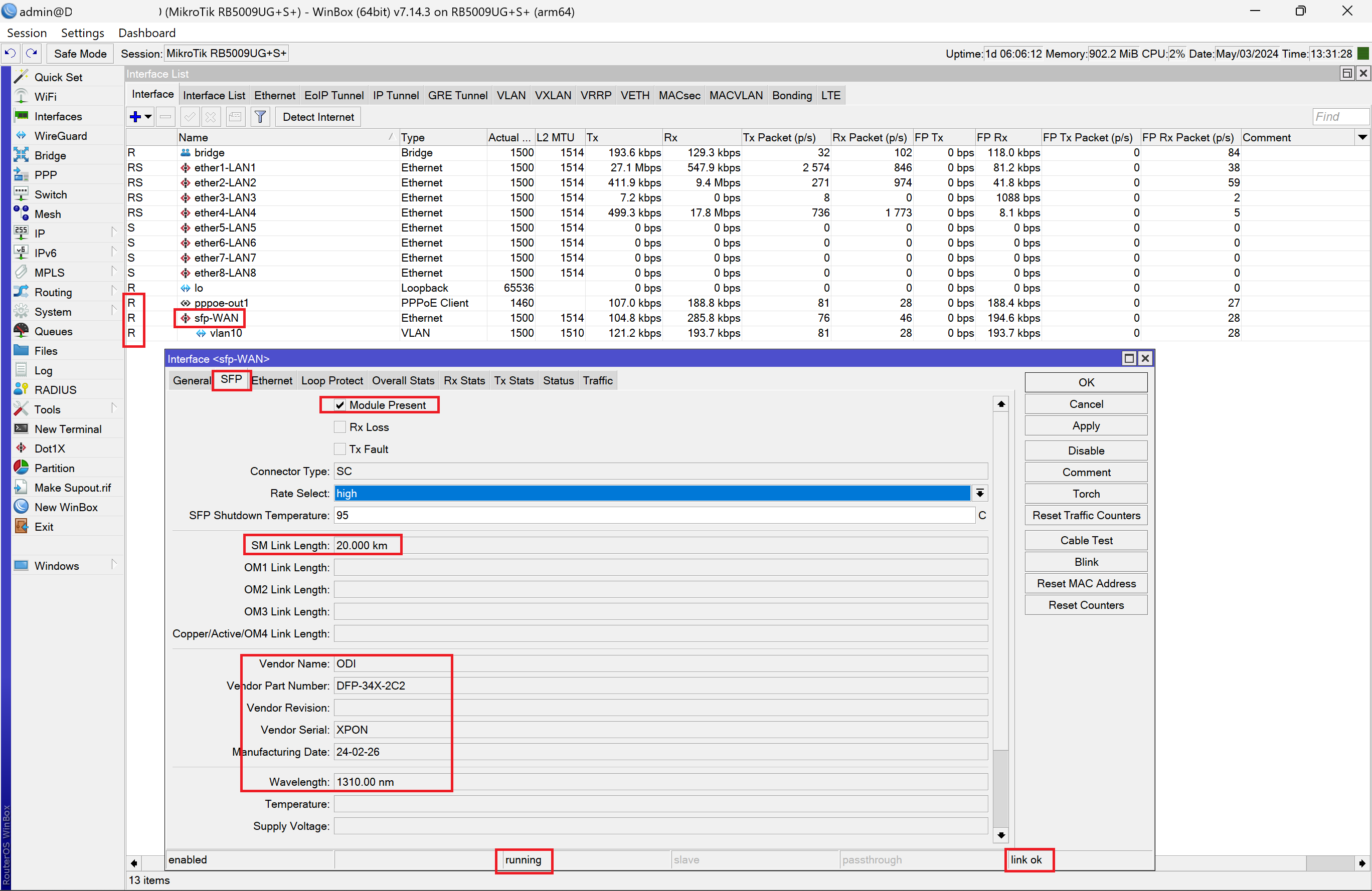

The SFP Port and vlan is showing in Italic, Wonder why that is
sfp-sfpplus1 interface doesn’t seem to be in connected/running state. What does ODI UI say about GPON status? You’ll have to verify it’s established between SFP+ module and OLT.
The GPON status is in Registered state - O5 and the SFP Module shows that its connected. It even picks up the VLAN from the ISP if set to AUTO.

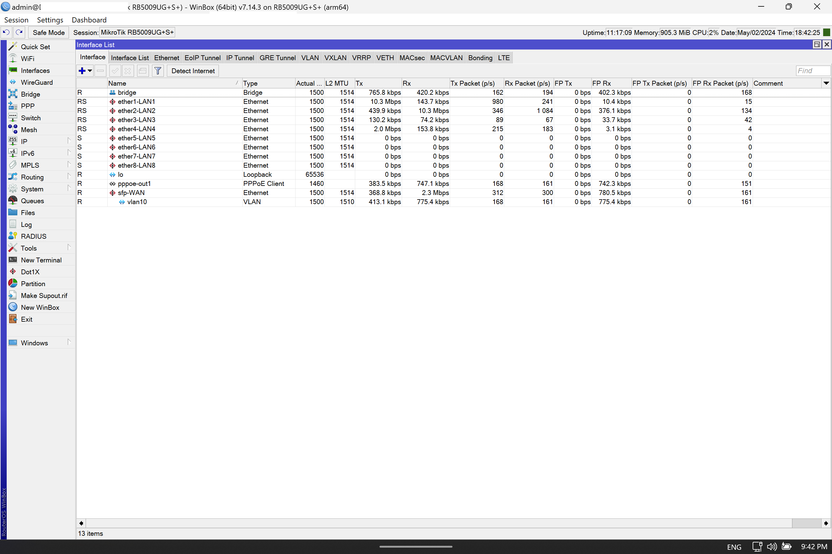

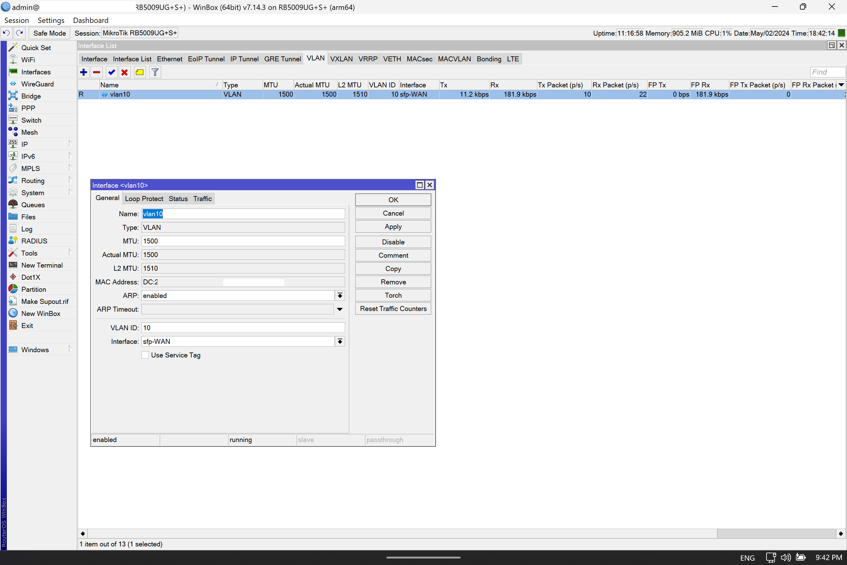

  1. I created a VLAN Interface with ID 10 as it was automatically detected by the ODI SFP Module. (ODI VLAN was set to transparent Mode)
  2. Assigned the VLAN to SFP Module and could see some Data Transfer over that VLAN 10 interface (This was not showing before)

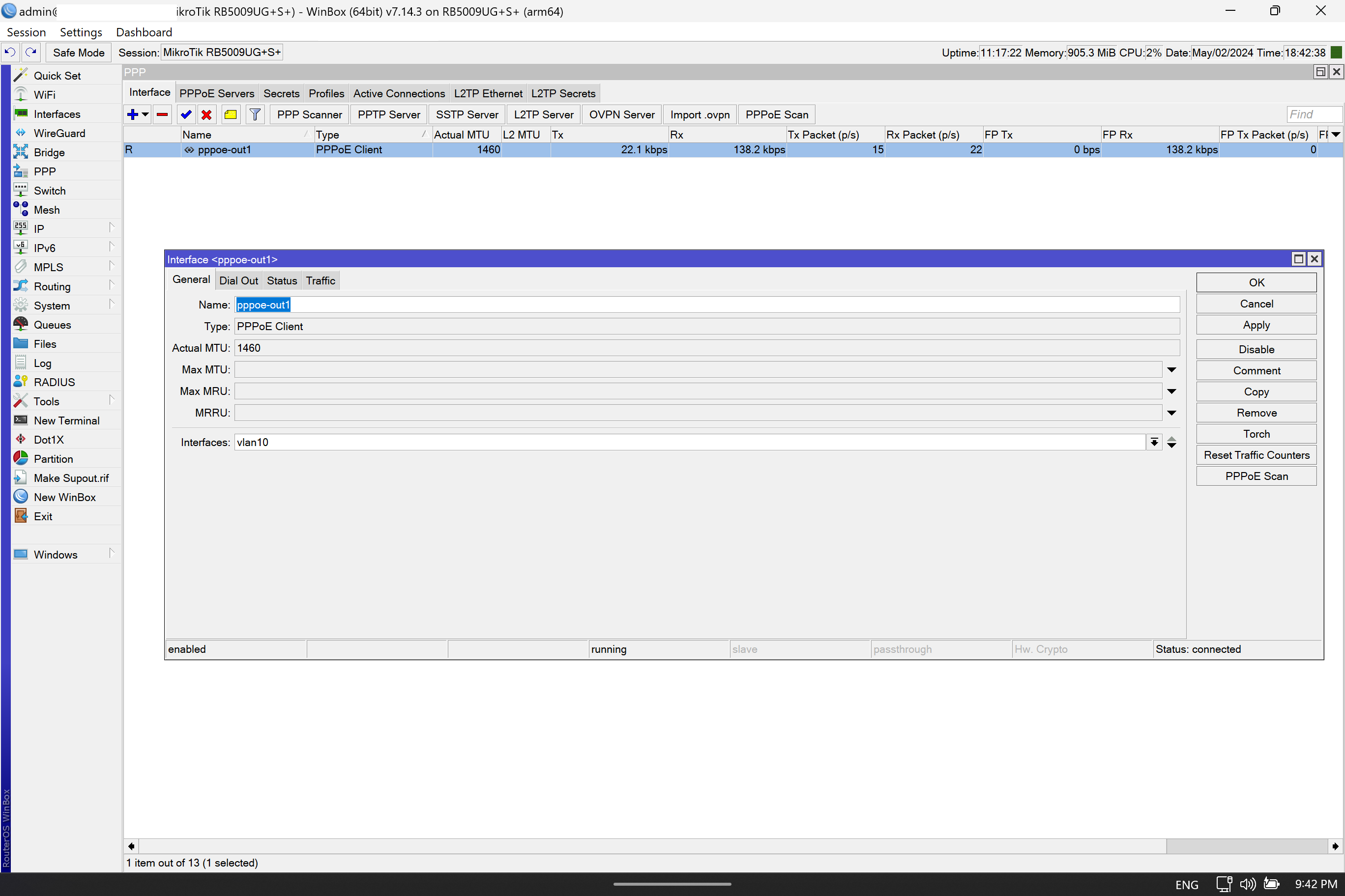

  3. Created a PPPoE on VLAN 10 Interface but it wasn’t able to establish a Dialup over it.
check if sfp connect

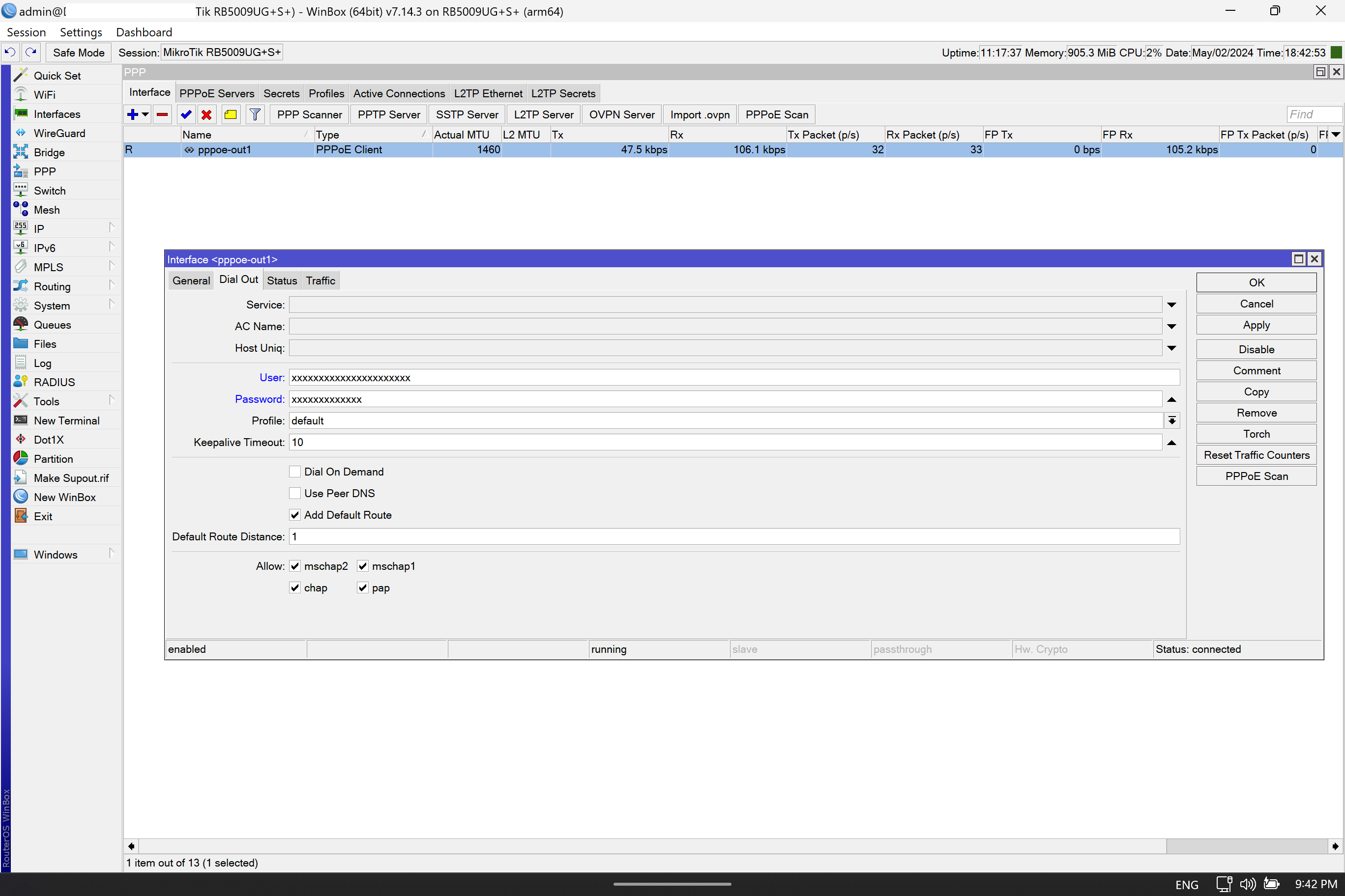

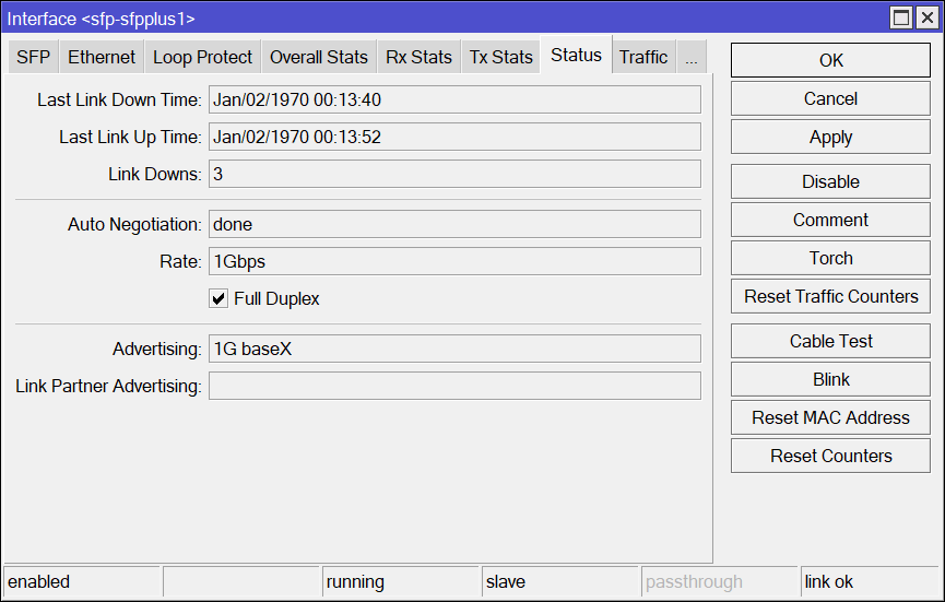

I finally got it to work, the solution was setting the Link Speed to 1G instead of the Auto Negotiate. Guess the ISP doesn’t Support 2.5G Link speeds yet. ODI Version was 240408.
I was able to establish a PPPoE Scan and a Dialup successfully.

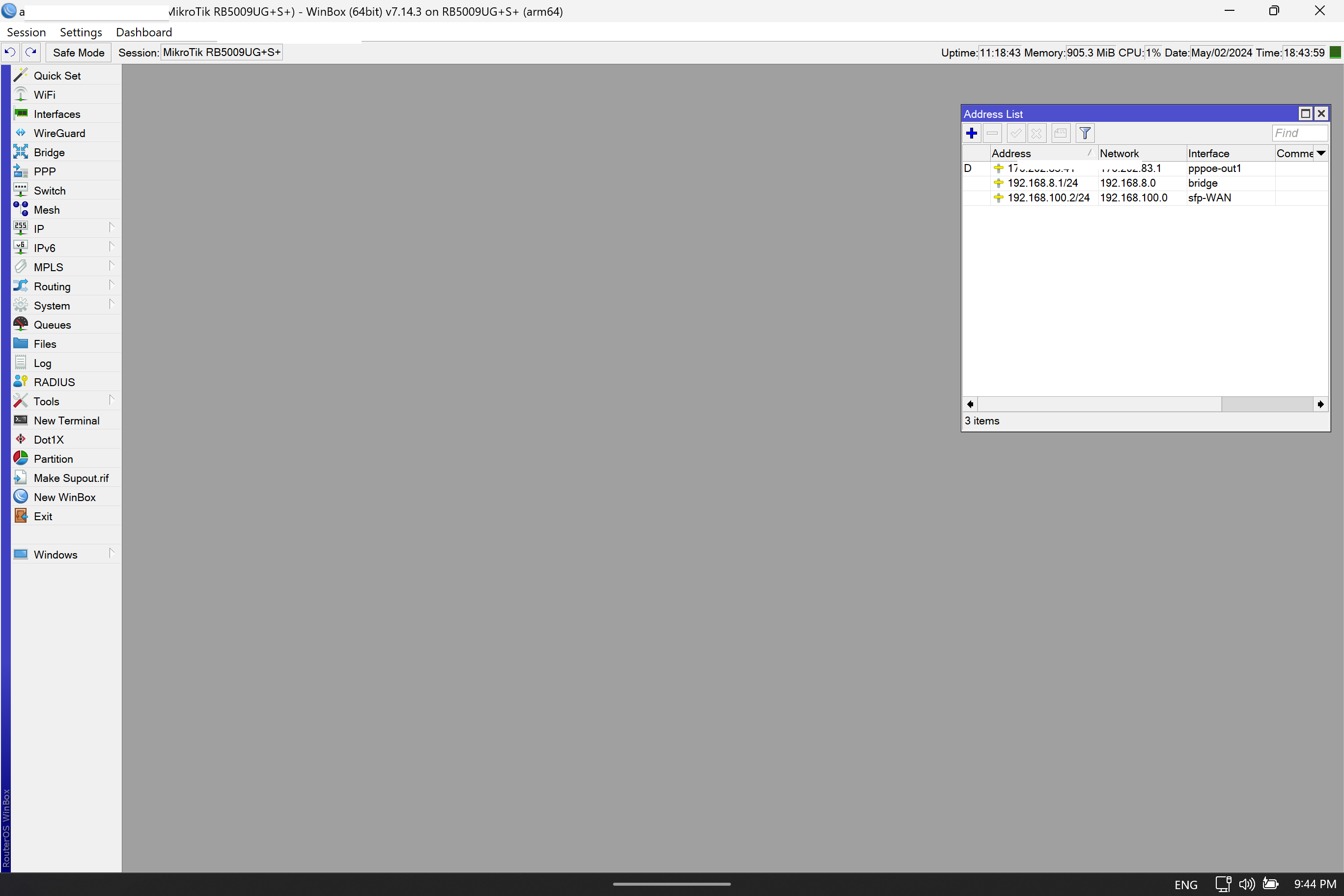

I am unable to access the WebGUI of the ODI though, since it’s on a different subnet:
LAN Subnet is 192.168.1.0/24
ODI SFP LAN is 192.168.2.1

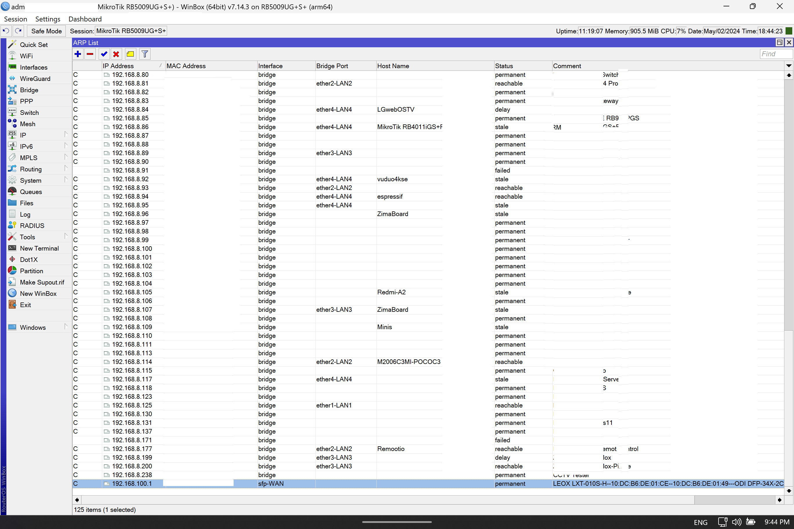

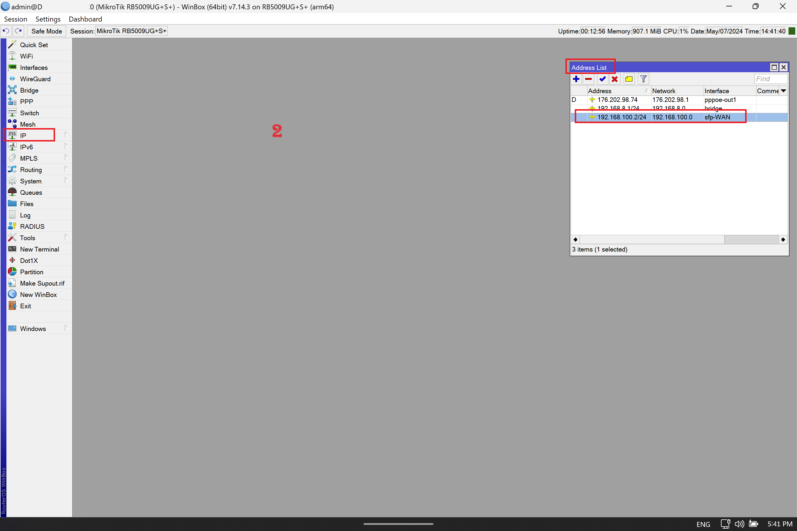

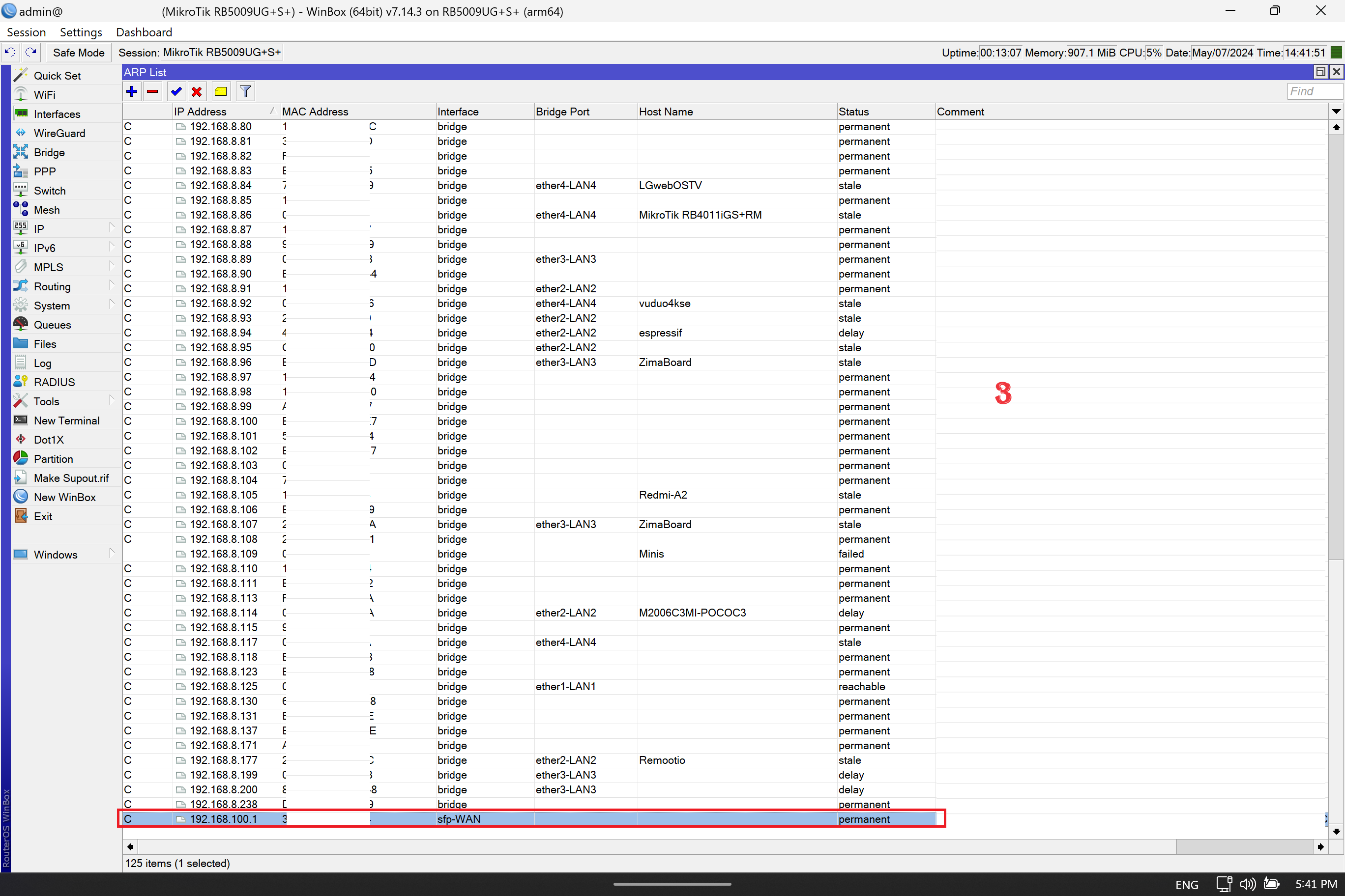

Add ODI IP Address and mac on ARP list and add IP Address on IP Address 192.168.2.2/24
I want to personally thank you for your assistance.
Everything works fine, Except for the ODI WebGui, I guess its because IGMP Snooping is Enabled. Hence the ARP isnt working as intended to. If I Disable it in ODI SFP, I loose the Port Forwarding for some weird reason.

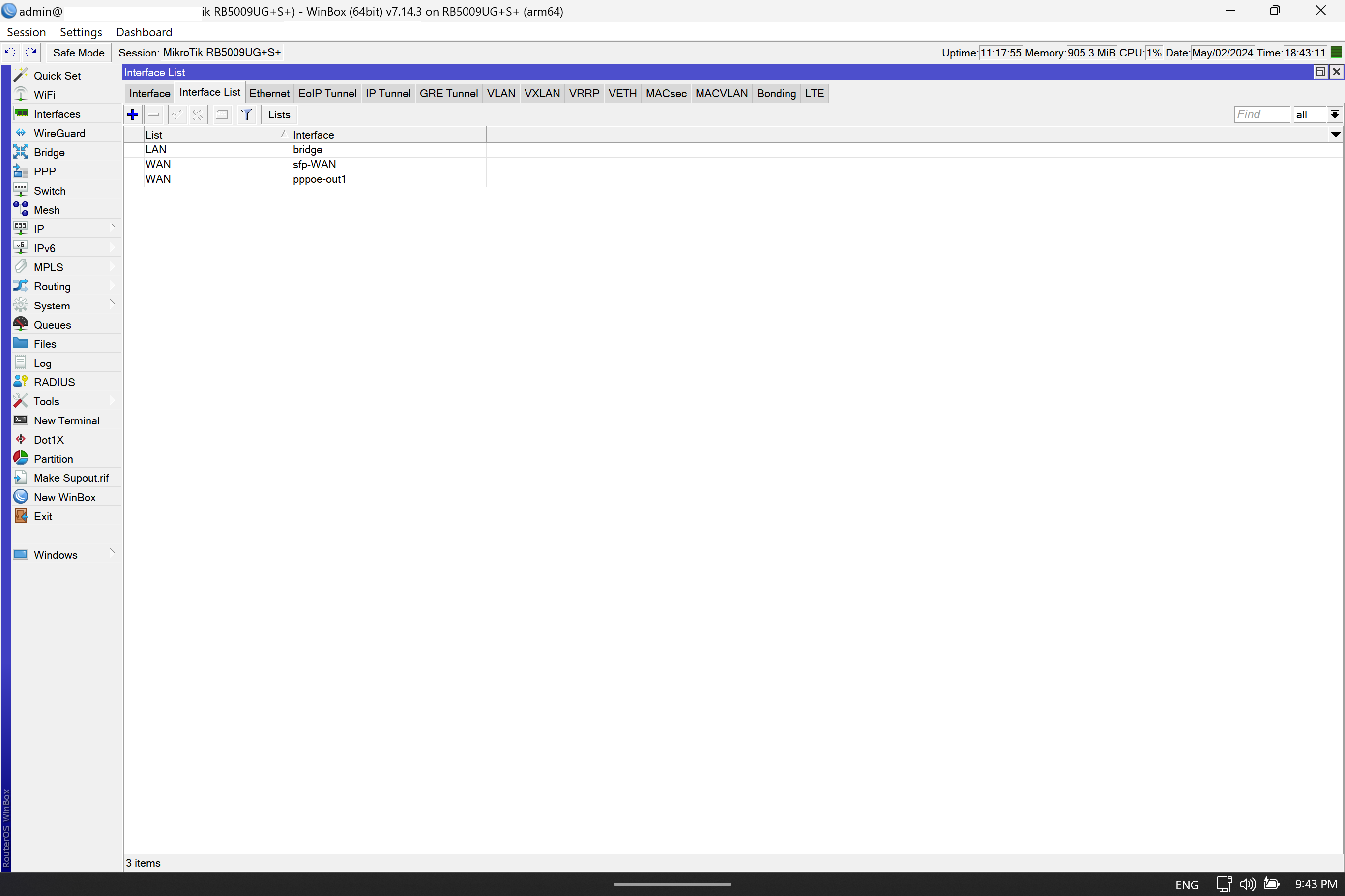

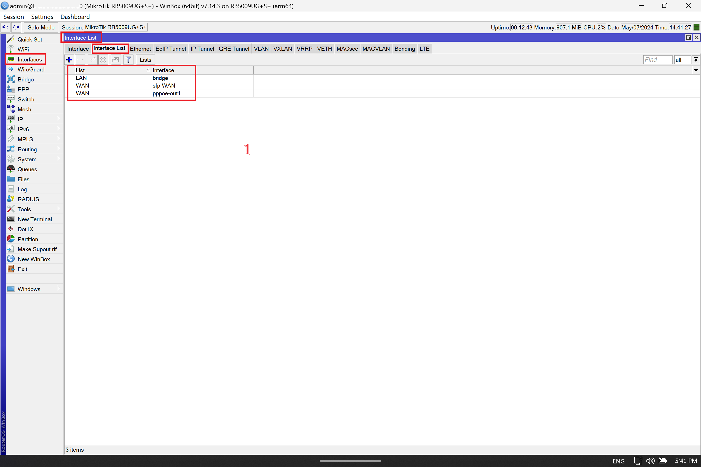

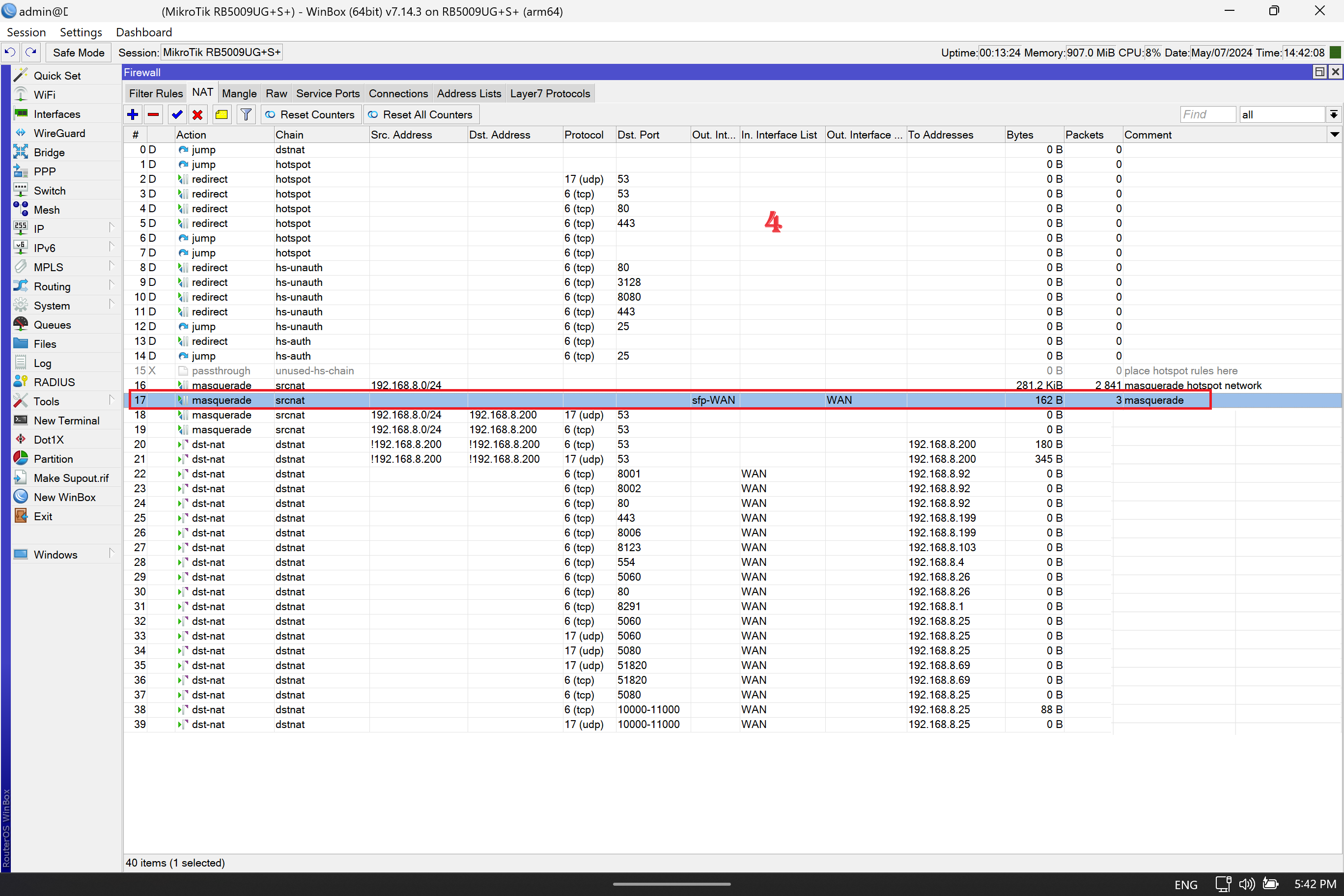

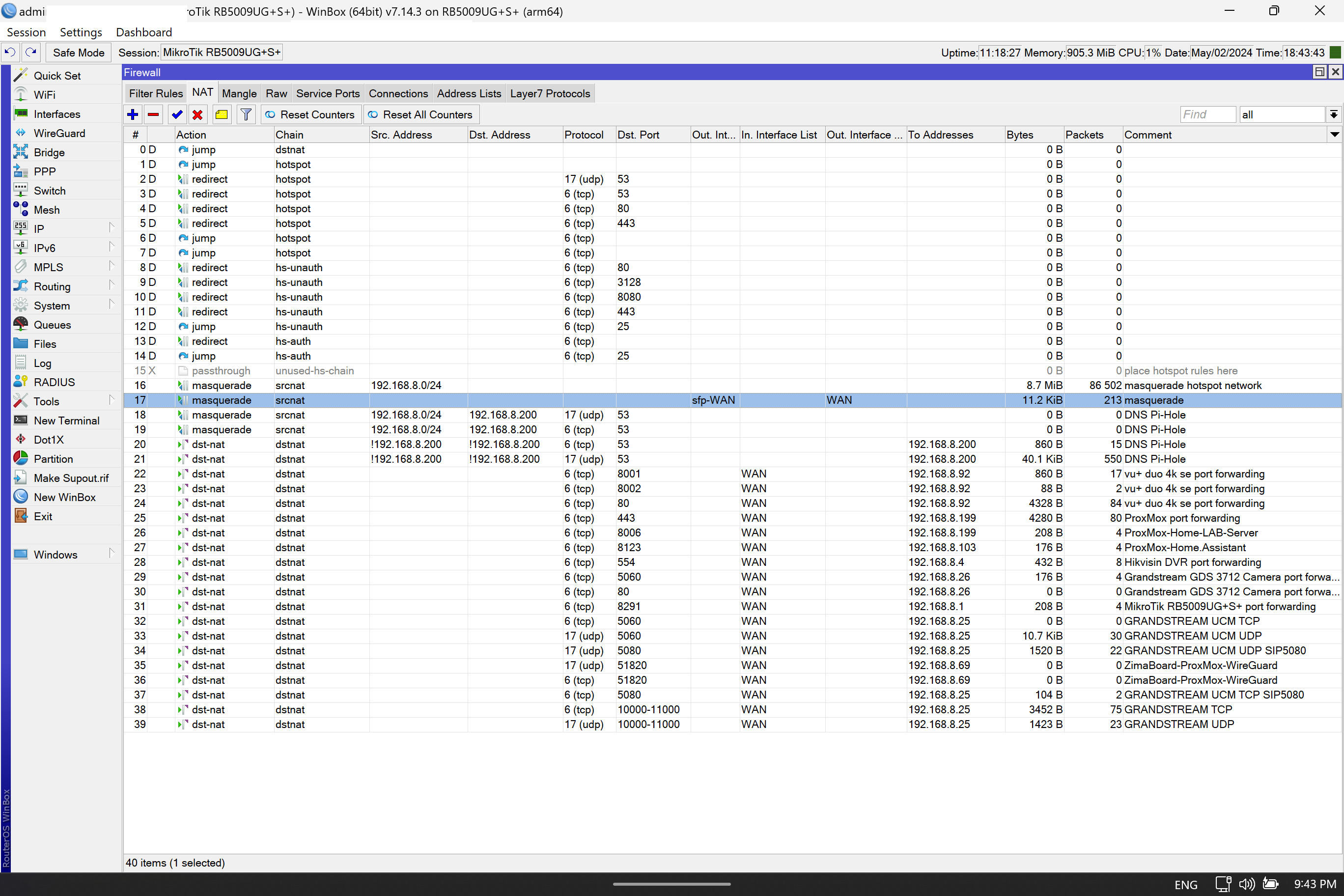

Under IP → Address, add the address 192.168.2.10/24 to the sfp-sfpplus1 interface (if pppoe-out1 sits on sfp-sfpplus1, if it’s on a vlan interface instead, then add this address to that interface).
Then if your configuration is based on the default configuration of the router (defconf), add the interface (sfp-sfpplus1 or vlan) to the WAN interface list (Interfaces → Interface List). This ensures that connection from LAN to the ODI WebGUI is properly NAT’ed (masquerade). If you don’t use the default configuration, then you’ll need to manually add a srcnat masquerade rule to IP → Firewall → NAT instead, for out-interface=sfp-sfpplus1 (or the vlan interface).
Now you should be able to access the ODI WebGUI with your web browser.
do this then you can access ODI webgui
thats right even me if I enable IGMP Snooping I loose prot forwarding so I disable it
Hi CGGXANNX and qatar2022,
Thank you for helping me, I have manually added a srcnat masquerade rule to or out-interface=sfp-sfpplus1 and added a permanent IP to the SFP in ARP List. I can now access the ODI WebGUI.

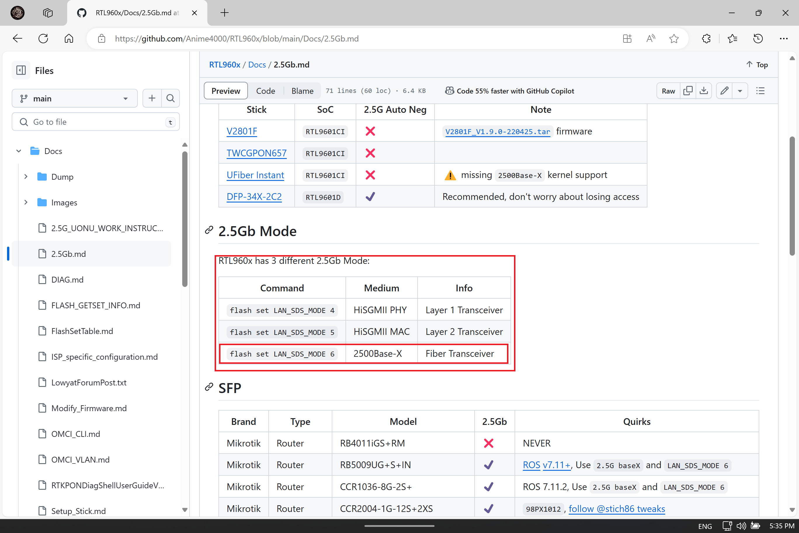

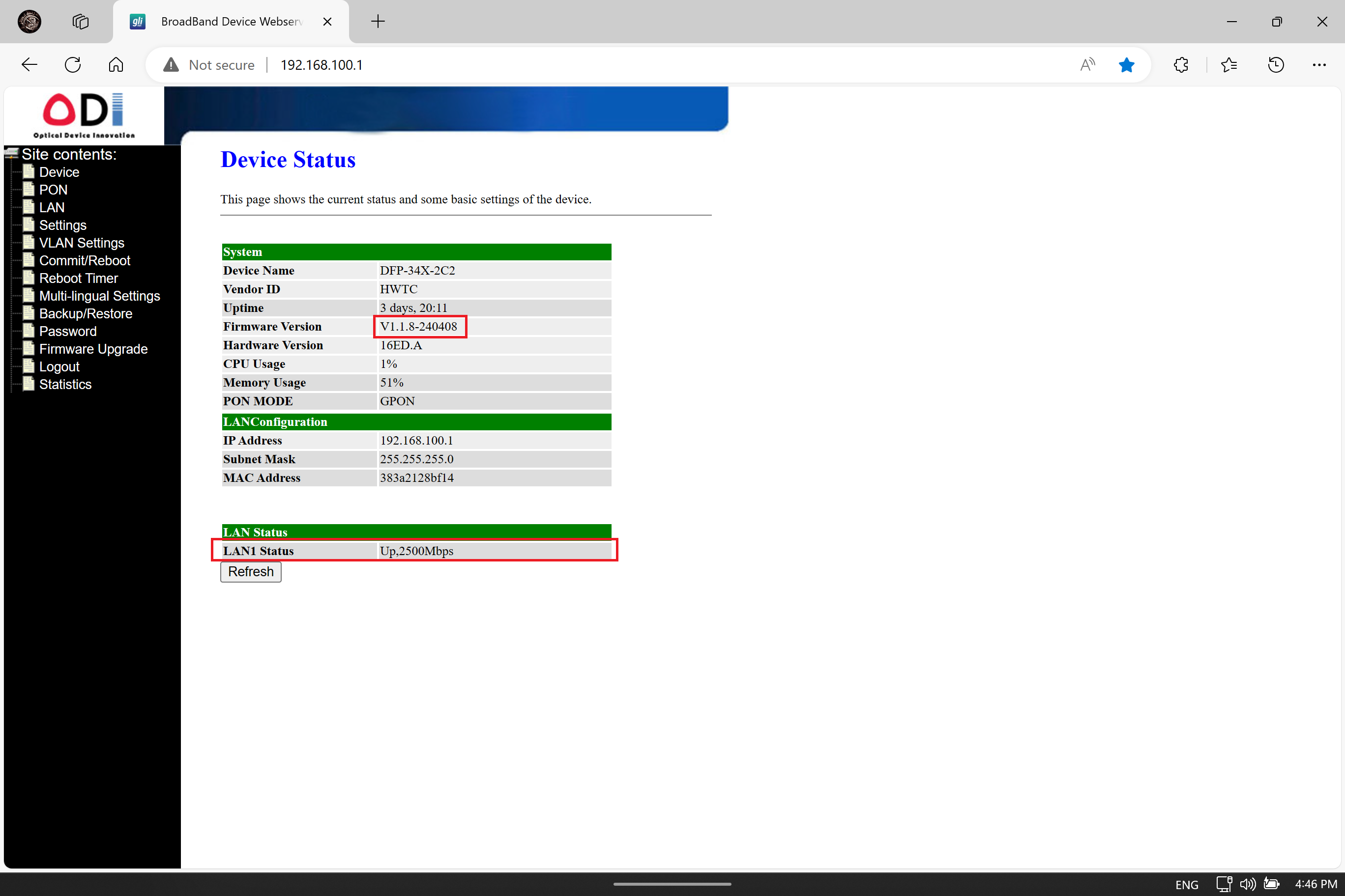

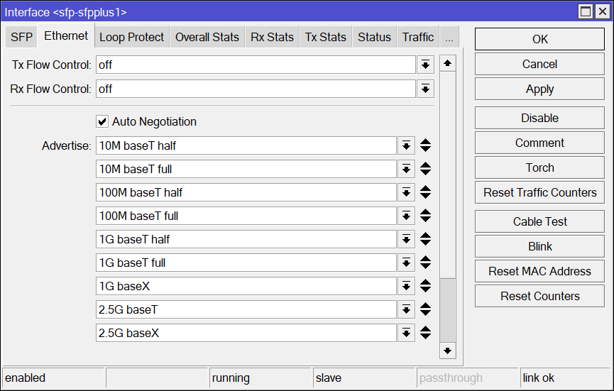

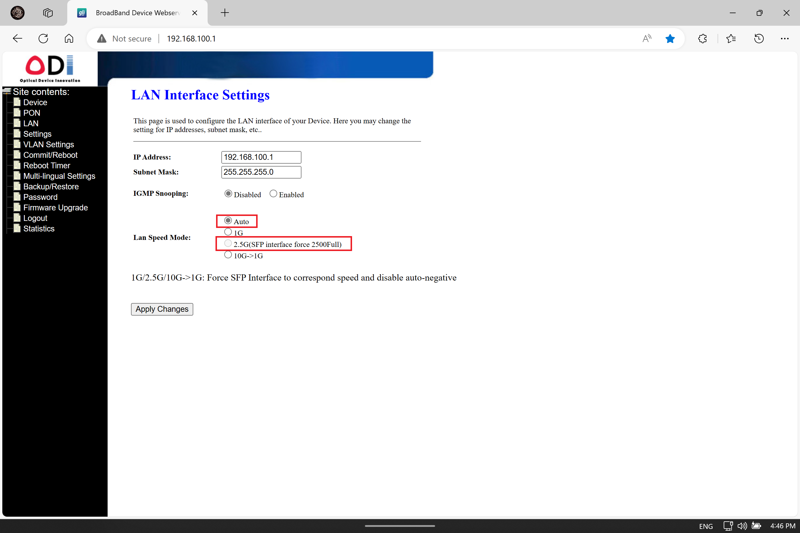

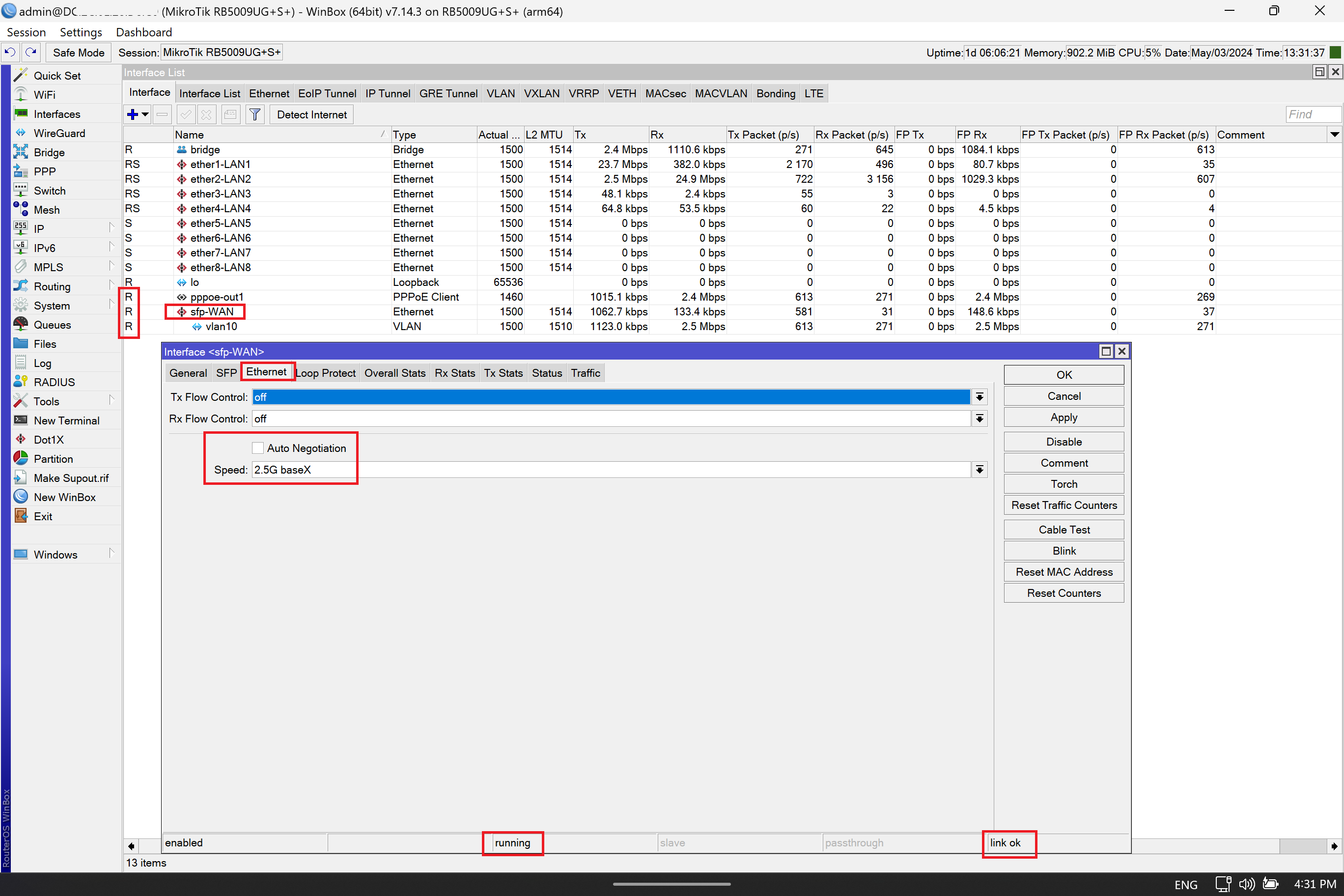

I have disabled the Auto negotiate and set the LAN Speed of the SFP to 1Gbps and then only I get a “link ok” status, any other speeds says “no link” even with or without the Fiber Plugged into SFP Module. Any reason why this could be happening? I cannot force 2.5G.

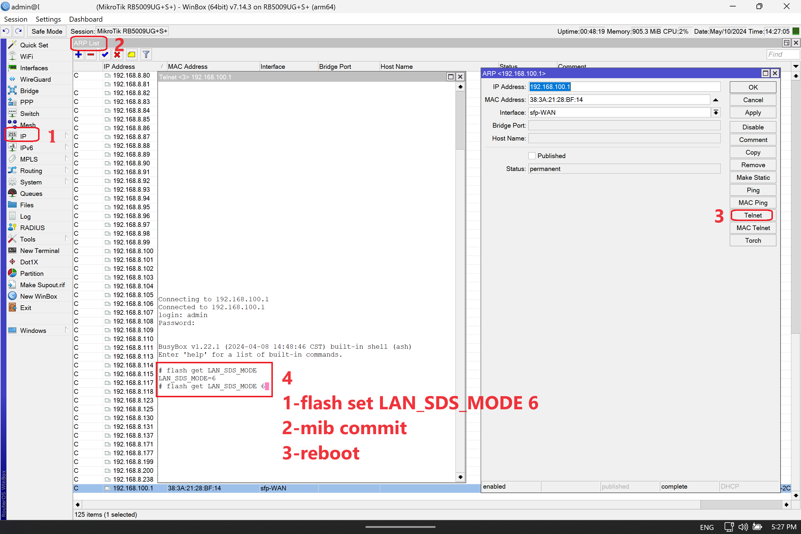

telnet sfp and write this command
flash set LAN_SDS_MODE 6
mib commit
reboot
after reboot check “flash get LAN_SDS_MODE”
you should get reply “LAN_SDS_MODE=6”

Since I could Telnet to the SFP I executed the Commands:
mib commit
After the Reboot, I Cant Initiate a PPPoE connection, Nor can i Telnet to revert back the changes. :frowning:

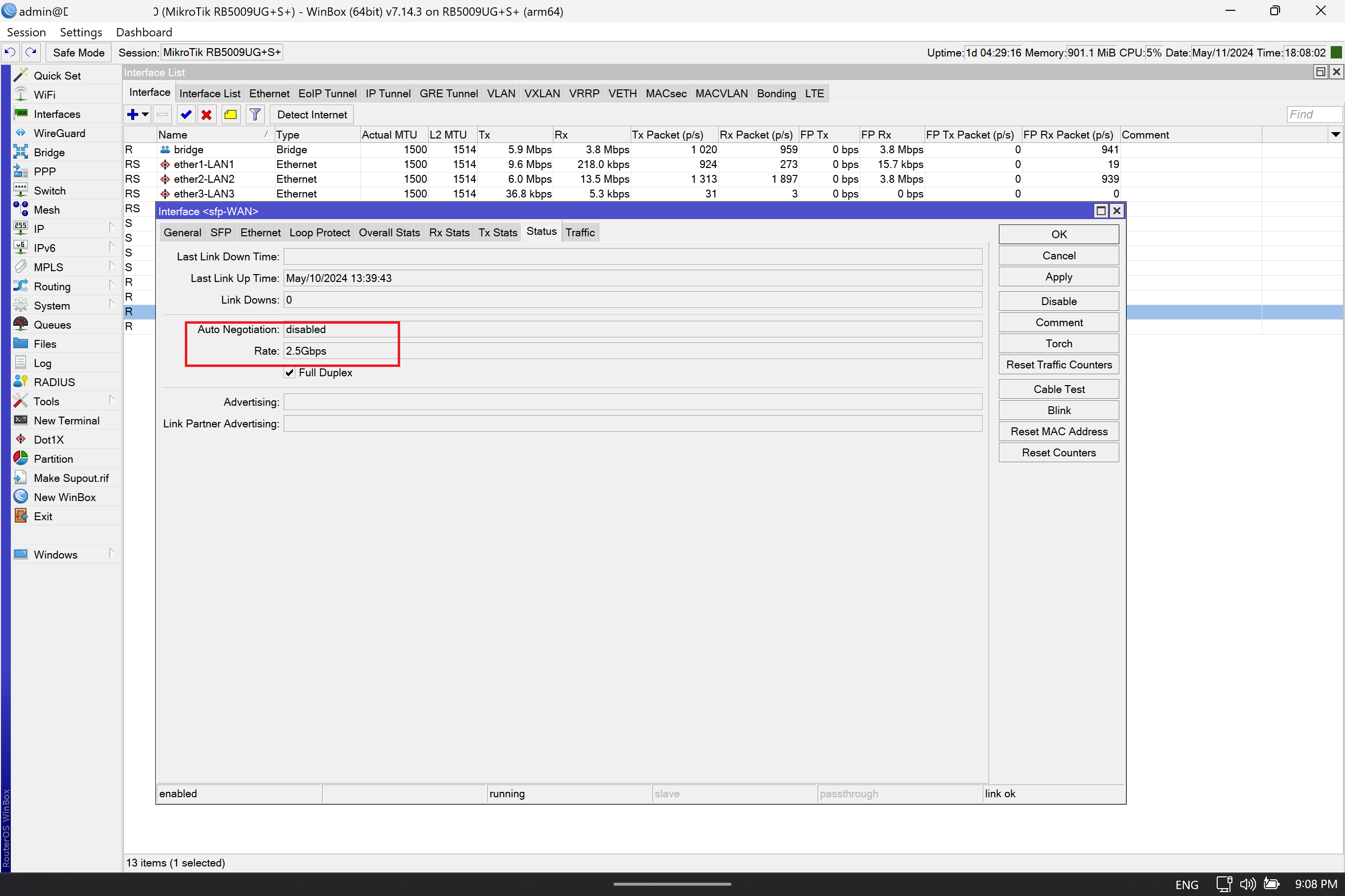

As far as I know with Auto Negotiation On the sfp with NOT work you have to disable it
see pictures
It finally worked, all I had to do was Disable Auto Negotiate and manually set the Speed to 2.5GBaseX and leave it for a while. It eventually achieved a “link ok” status after like 5-7mins. Didn’t have to Telnet and force it.
