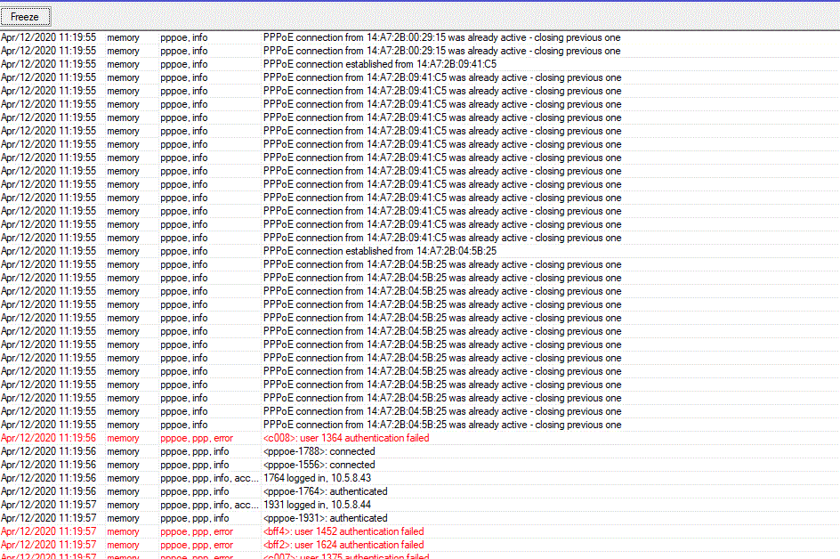

i am also facing same issue can any one suggest how to solve, its disconnecting all 800 + user in 1036 ccr router , attached is screen shot

I facing “pppoe connection was already active closing previous one” issue can any one suggest how to solve, its disconnecting all 750 + user in CCR1036-8G-2S+ Router
