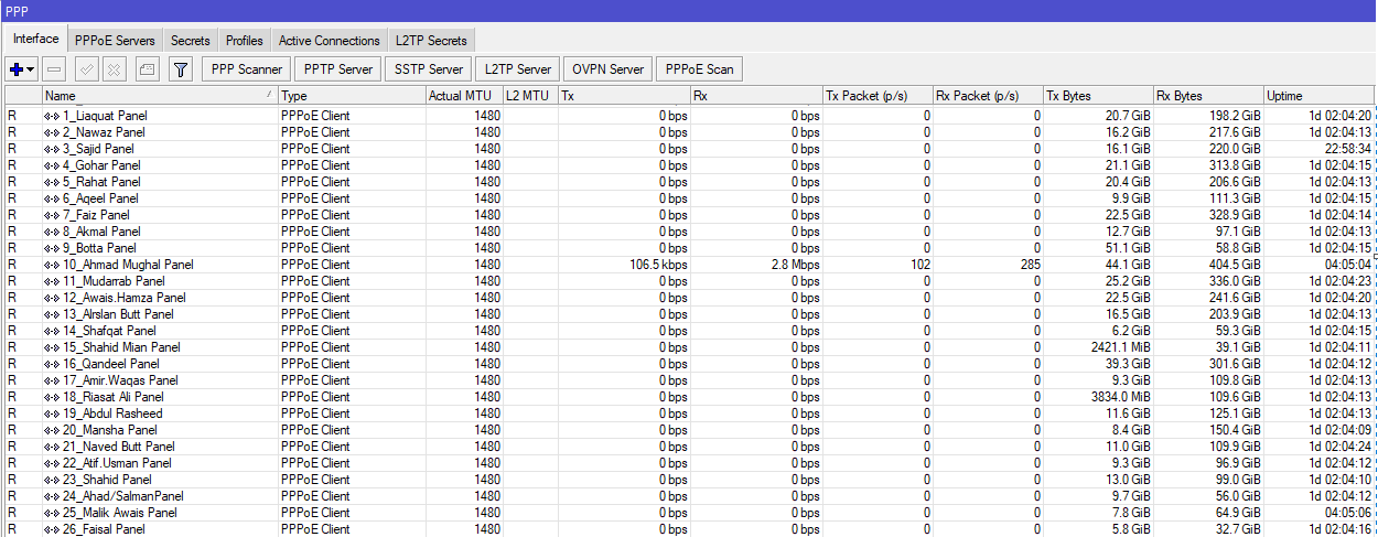

I have attached the screenshot of my PPPoE client which is connected. All PPPoE client from same ISP

From an image you can't deduce the version, the hardware used, the configuration (but I guessed the MTU...) and how the devices are connected.

Is there a reason so much traffic overhead for nothing?
Why do you have 26+ PPPoE connections to your usual ISP instead of just one?
Obviously not knowing how the rest is configured...
My ISP gave me a Panel for user creation. So for the monitoring of users' data, I dialed these connections first in my Mikrotik, and all my users connected with my "Mikrotik PPPoE server" Once they connected they are marked with relevant user IDs with their PPPoE Client. In this way, I can find how many users are using the Internet.
See the screenshot for further information.

PPPoE session that disconnects and not automatically reconnect could be high CPU usage on your device(looking at all those routing marks). But you will have to post your entire config so we can see how its setup. That way we can provide you with an explanation and/or give suggestions how to improve the config
