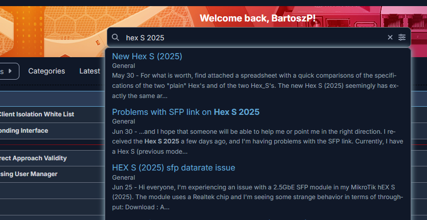

Search forum for hex S 2025. That model has some issues but new version of ROS helps a bit.
