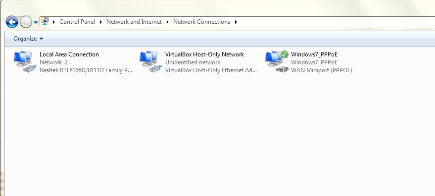

Default configuration for Windows7 Home Premium too.
I do not have any problems with PPPoE connection, see attached picture.
I thing PPPoE server configuration might be the reason for your problem.

  1. Check encryption settings on both ends /ppp profile and Windows7 computer.
  2. Do you have any other Windows7 computer in your local network? Perhaps Windows7 computer settings are overcustomized.
I tried to disable the encryption settings on both ends, no success with Win7. I also tried PPPoE on the physical interface (without VLAN), no success with Win7 either.
So far, both Linux and WinXP work properly. Win7 disconnects after the “Registering computer on the network” phase.
For the records, I have finally spotted the problem.
There was an IPSec VPN Stack installed on Windows7 which prevented the PPPoE client from connecting successfully.
The Windows7 computer was overcustomized after all.
