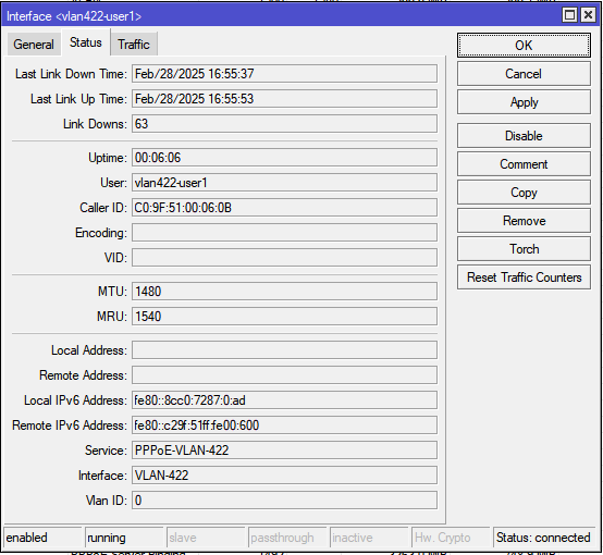

Hi everyone, currently I’m setting up PPPoE server to support MTU of 1540 for my PPPoE client (Router/DUT). However, the first connection MTU is 1492 then reconnects with 1540 then suddenly it changes to 1480

Mikrotik changed it to 1480

I don’t know why Mikrotik changed the MTU from 1540 to 1480. This environment is for MAP-E.

Usually that’s because RouterOS could not send a test LCP EchoReq message as large as the specified MTU after establishing the PPPoE connection, which causes it to drop MTU to 1480. And probably the message could not be sent because the produced ethernet frame is too large for the underlying layer 2 network. You have increased L2MTU and MTU on the router to 1600, but are you sure that the adapter on the other side, as well as any switches in between, also support ethernet frame large enough for that? If they don’t then they drop the frame, RouterOS doesn’t get any answer for the LCP EchoReq message and after a few tries + timeout, drops the MTU of the PPPoE connection.

Currently, I’ve directly connect my PPPoE client to my Mikrotik
I’ve change the MTU to count for overheads
MTU
Bridge: 1562
VLAN: 1562
Ethernet Port: 1562
PPPoE Server: 1540
However, when I’ve captured the packet and the negotiation. I have PPP LCP packet length of 1566 and that is very large for LCP packet.
Still, there is a LCP missed echo reply. I just want my PPPoE client to have an MTU of 1540.
Have you tried what I wrote to you?
Server side:
Ethernet MTU 1500 (pppoe is not a L3 protocol, useless increase MTU)
Restore original ethernet L2MTU of 1580 (suffice for VLAN + PPPoE)
Bridge MTU AUTO (remove the MTU)
Set VLAN MTU to 1548
Set PPPoE Server Max MRU and MTU to 1540 and do not set MRRU (remove)
Client Side:
i do not think a bridge is involved here
Ethernet MTU 1500 (for the same reason, pppoe is not a L3 protocol, useless increase MTU)
Set PPPoE Client Max MRU and MTU to 1540 and do not set MRRU (remove)
I've tried this also.
PPPoE server MTU/MRU both 1540
However, the MTU of the PPPoE client is 1480. From 1540 to 1480.
Also, I don't know why Mikrotik send a PPP LCP packet that have a length of 1566. I think this is why the PPPoE client don't send a Echo Reply because the PPP LCP frame is too large.
