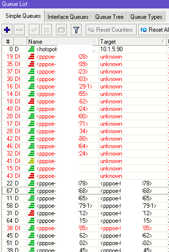

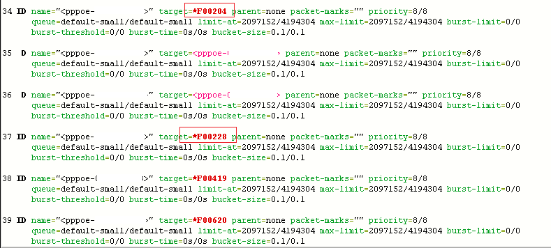

I have a weird situation on one router 5009 with PPPOE server. Sometimes the target end up being weird characters, and when that happens in influence all the other users.
On winbox under queues it displays the target as
Using a 5009, ROS 7.2.3

Hi Zacharias, thanks for the reply
Yes in the queue’s it displays the target as , but on the setup of the PPPOE server it is setup as a VLAN-interface

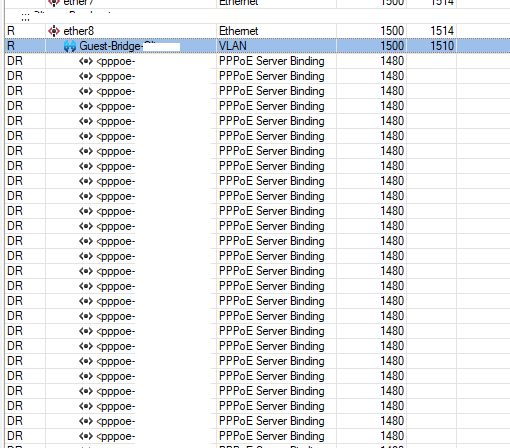

Does that VLAN interface exist ?
sorry lost you there
/interface vlan
add interface=ether8 name=Guest-Bridge vlan-id=4001
vlan
interfaces
tx
chris
hey,
heres a pic of the queues
tx
chris
