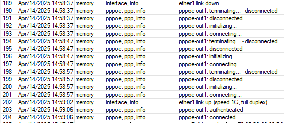

I noticed that something doesn’t quite work, because every now and then the connection is broken:

@anav - When I make the following change, interface=ether1 from interface=pppoe-out1, I am unable to ping 8.8.8.8.
add address=91.220.222.78/24 interface=ether1 network=91.220.222.0
The disconnection problem is probably on ISP’s side.
The last firewall rule “Drop all from WAN not DST-NATed” should apply to out-interface=pppoe-out1 and not ether1.
You’re also missing a rule for dropping all input not from LAN, so again you’re vulnerable.
The default firewall should be present 1:1 (without any removed rules) before you fully understand how it works because the aforementioned rule protects the access to your router from outside. If you need such, a VPN should be set up
