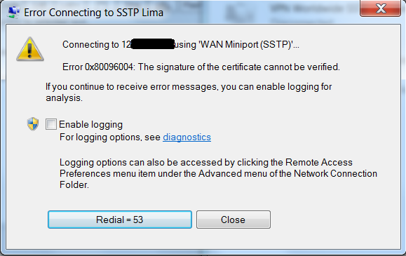

I already followed the instructions in the certificate making process and it was already accepted by Mikrotik. My problem is that the SSTP Client of Microsoft cannot connect me to my SSTP Server. Do you have any idea what client software can I use in order for me to connect to my SSTP Server. Thanks

I already followed the instructions in this video:
https://www.youtube.com/watch?v=MbGHi35Pe00
But I still receive an error on my Windows 7 VPN Utility.
I think the issue here is the OpenSSL Creation. Is the “Common Name” in OpenSSL the IP Address of the SSTP Server?
