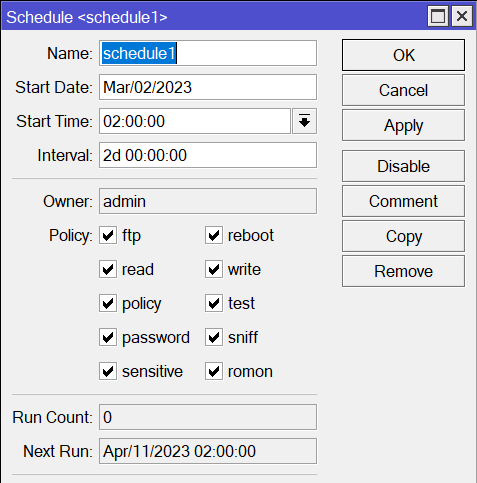

in this screenshot what all this check box mean..?

Add to the rule “0” the comment “Rule A” (without quotes)
Add to the rule “2” the comment “Rule B” (without quotes)
Paste this on terminal.
/system scheduler
add interval=2d name=enable-routing-rule-a on-event="/routing rule\r\
    \nenable [find where comment~\"Rule A\"]\r\
    \ndisable [find where comment~\"Rule B\"]\r\
    \n" policy=ftp,reboot,read,write,policy,test,password,sniff,sensitive,romon start-date=apr/01/2023 start-time=04:00:00
add interval=2d name=enable-routing-rule-b on-event="/routing rule\r\
    \nenable [find where comment~\"Rule B\"]\r\
    \ndisable [find where comment~\"Rule A\"]\r\
    \n" policy=ftp,reboot,read,write,policy,test,password,sniff,sensitive,romon start-date=apr/02/2023 start-time=04:00:00
Done.
On reboot the routerboard keep same previous routing rule enabled, and everynight @04:00 (AM) switch the two rules.
Since the schedulers are on two different days, the rules are switched correctly.
Do you also need something that if the routerboard is off at 04:00 (AM) still syncs the right rule at the start without waiting for 04:00 the next day?
