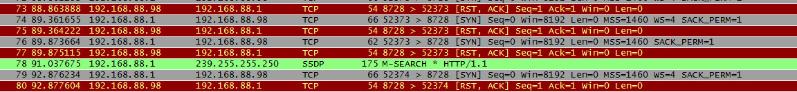

Problem connect Mikrotik when using API
Currently, I’m using MikroTik RouterOS 5.26 and try to implement API for developing management program.
Now is testing stage. Diagram Mikrotik (192.168.88.98)—>PC (PHP) 192.168.88.1.
I can ping or even telnet from PC to Mikrotik as shown in picture telnet_get.jpg
Username=admin Password=null

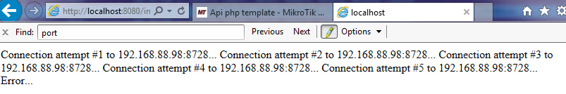

I tested with int_list.php as show in attachment.
However, it cannot work properly. On capturing display as shown in below.
On browser display showed connection attempt many time and stop finally.
Question
1.Why do packet in php_get.jpg picture source = 192.168.88.98 instead of source =192.168.88.1
compare between telnet function.
2.Why the destination socket is not wellknow port (22,23..) Can we specify port in PHP program.
Please advise how to solve the connection problem
Thank you very much

Make sure the API service is enabled in “/ip service”.
Also, make sure you allow Apache’s httpd.exe and/or PHP’s php.exe to make outgoing connections in Windows’ firewall.

Do you have an additional firewall program on your computer? Perhaps if one is bundled with your Anti-virus package (as is the case with, e.g. Norton 360 or any “[brand] Internet Security”)?
And again - is the API service enabled in “/ip service”? On port 8728?
(You’ll be surprised how often people forget to enable it…)
If there are any IP restrictions, you might want to temporarily remove them too. Both in the “/ip service”, and in the “/user” sections.
If your password is blank, leave the password argument to an empty string, rather than a space, i.e. instead of

From the MikroTik router. You could either run the virtual machine directly (I’m guessing you know how to do that, 'cause I don’t; I haven’t had such a setup yet, though now I’m starting to think I should…), or perhaps connect to it via a different protocol (Winbox, SSH, etc.).
If you use a terminal interface (like SSH or directly running the VM), you can check those settings by literally typing
/ip service print
hitting Enter, and seeing what is the result. If the API needs enabling, you can enable it with
/ip service enable api
Similarly with “/users”, i.e.
/user print
to see all users and their IP restrictions (if any), and
/user unset "admin" "address"
to remove any IP restrictions from the username “admin”. And last, but not least, ensuring the user’s group has “api” privileges. Assuming the group for “admin” is full, then by doing
/user group print
you should see
name=“full” policy=local,telnet,ssh,ftp,reboot,read,write,policy,test,winbox,password,web,sniff,sensitive,> api > skin=default

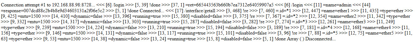

Thank you so much boen_robot
after api enable
It works , I can run this script (int_list.php) as shown in below.
I try to the other scripts in the next time.
Have a nice day.

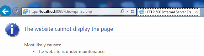

I have some problems when I tried to use this example showipmac.php as shown in below.
I copied PEAR2_Net_RouterOS-1.0.0b4.phar file in the same directory ( as shown is directory.jpg)with showipmac.php.
I got HTTP 500 internal Server error on screen as shown in error_PEAR.jpg whereas I still run resource.php.
Question.
3.What 's happen about my program or PEAR…phar? I tested among three type of declaraltion
  • include_once ‘PEAR2_Net_RouterOS-1.0.0b4.phar’;
    -require_once ‘PEAR2/Autoload.php’;
    -require_once ‘PEAR2_Net_RouterOS-1.0.0b4.phar’;
    noone work at all.
The first problem I see is that you haven’t replaced your IP address accordingly. You’re using 192.168.88.98, but you’ve left the IP in the example code of 192.168.0.1. Because the client can’t connect, it throws an exception, and because it throws an exception, and it is never caught, this results in a fatal error and error code 500, which IE then represents with a custom error page (sadly).
Try to catch the exception… and fix the IP of course… i.e.

Hi Boen_robot
I still fail to use your API again, even I fixed new ip and add exception command as shown in below.
The display is the same with the previous time "HTTP 500 internal server error "
(I still ran resource.php )
Question
1.Can I debug status of your api like ( API-debug=true)? Do you have any command?
2. Why I did not see any other messages even I put “Exception command”
I should see echo ’ Unable to connect ’ when I cannot login or
I should see a successful login when I can login?
Here is a latest file (showipmac.php).
Thank you so much again.

  1. Why I did not see any other messages even I put “Exception command”
Yes.
There’s nothing “bolted on” (Because it would needlessly hurt performance), although you could always use PHP’s tools like var_dump(), XDebug, etc. over $client or any other variable containing a related object.
Exceptions are thrown whenever something is outside of normal protocol flow.
Because an exception was not thrown, it appears the problem is you have PHP 5.2, instead of PHP 5.3 or later. In that case, there’s a parser error, which is triggered as soon as the file is included/required.

1.According to your suggestion, I am using PHP 5.3.17 as shown in php_ver.jpg
It ensures your API should work with PHP 5.3.17
2. However, I put showmacip.php at the same directory of PEAR file.
3. I found php_error.txt
Here is content, It generated when I execute that script.
[26-Jan-2014 18:45:00 UTC] PHP Parse error: syntax error, unexpected ‘/’ in C:\Apache2\htdocs\showipmac.php on line 4
Here is showmacip.php
<?php use PEAR2\Net\RouterOS; include_once 'PEAR2_Net_RouterOS-1.0.0b4.phar'; /require_once 'PEAR2/Autoload.php'; /require_once 'PEAR2_Net_RouterOS-1.0.0b4.phar'; try { $client = new RouterOS\Client('192.168.88.98', 'admin', ''); } catch (Exception $e) { echo 'Unable to connect and/or login to the router'; } 4.Thus, I deleted /require_once two lines out and change file to showcpu.php instead. Here is showcpu.php <?php use PEAR2\Net\RouterOS; include_once 'PEAR2_Net_RouterOS-1.0.0b4.phar'; try { $client = new RouterOS\Client('192.168.88.98', 'admin', ''); $util = new RouterOS\Util($client); $util->changeMenu('/system resource cpu'); $load = $util->get(0, 'load'); echo $util->get(0,'load'); } catch (Exception $e) { echo 'Unable to connect and/or login to the router'; } 5.I run again , It showed a number that I expected this is cpu load value. I think it works now. 6.Please explain more about two lines as shown in below. $load = $util->get(0, 'load'); echo $util->get(0,'load'); Thank you so much ![php_ver.jpg|603x150](upload://p3m6F1odG83YLSwoFMMlvfFyE26.jpeg)
5.
Great. I’m glad it worked out, and I apologize for not noticing this simple syntax error.
$load = $util->get(0, ‘load’);
echo $util->get(0,‘load’);
The whole Util class is filled with frequently used functionality, abstracted away in single methods. A particular motivator was the inability of the API protocol to accept numbers. In other words, if you try to target an entry in the API like “/system resource cpu get numbers=0 value-name=load”, you would get an error, because it doesn’t recognize the number “0”. You instead need to use the item’s ID.
When you first call get() with a number, it fetches all items’ IDs. It also takes the first ID returned to be the ID of item with number 0. See the Util class’ reference page for details on this, and other Util methods (of which, if you ask me, get() is the least exciting one). Or perhaps see this wiki page if you prefer a more tutorial-ish form.
