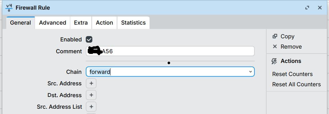

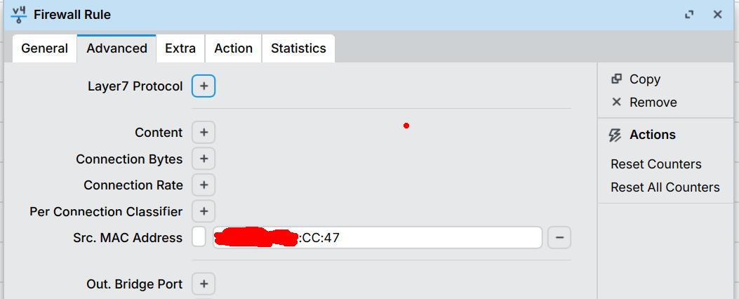

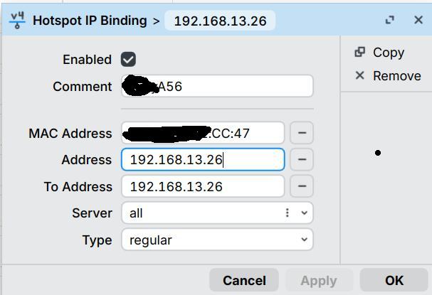

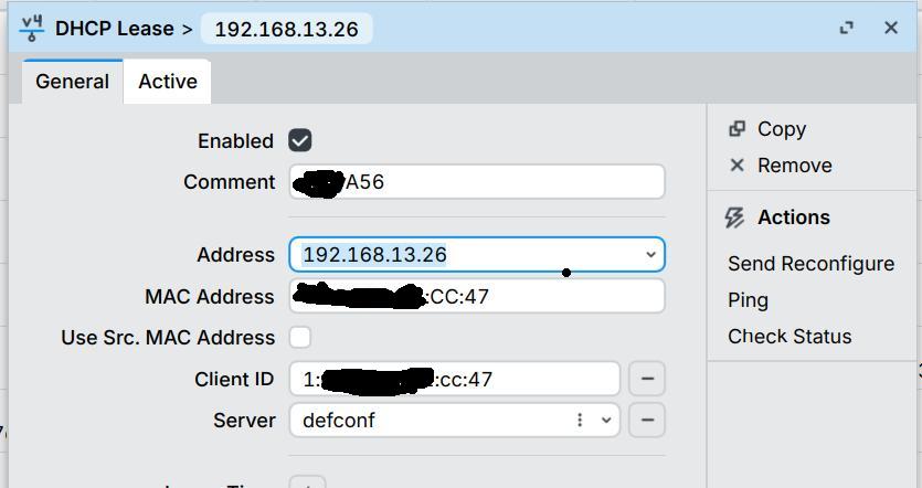

We just bought new mobiles (Samsung A56 and A26), but I’m not able to get them connected to internet via Mikrotik AP.
I have set Leases (status: Bound), IP Bindings and Firewall same way as I have for other mobiles and laptops (which works OK), but I’m not able to get connected new mobiles to internet. Always get “Connected, no internet connection”.
Both mobiles get IP as per they MAC addresses, but they cannot get to internet.
MAC is set “as mobile device”, not randomized. I’m out of ideas, any idea why these new mobiles cannot get internet access? Thank you very much for help.

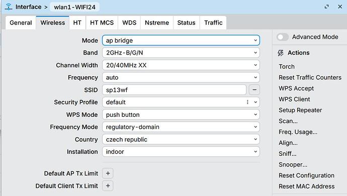

here is annomized file, hopefully I remove all private data … but when I was doing it I found out it is quite a mess, so probably I should wipe it out and setup from scratch …

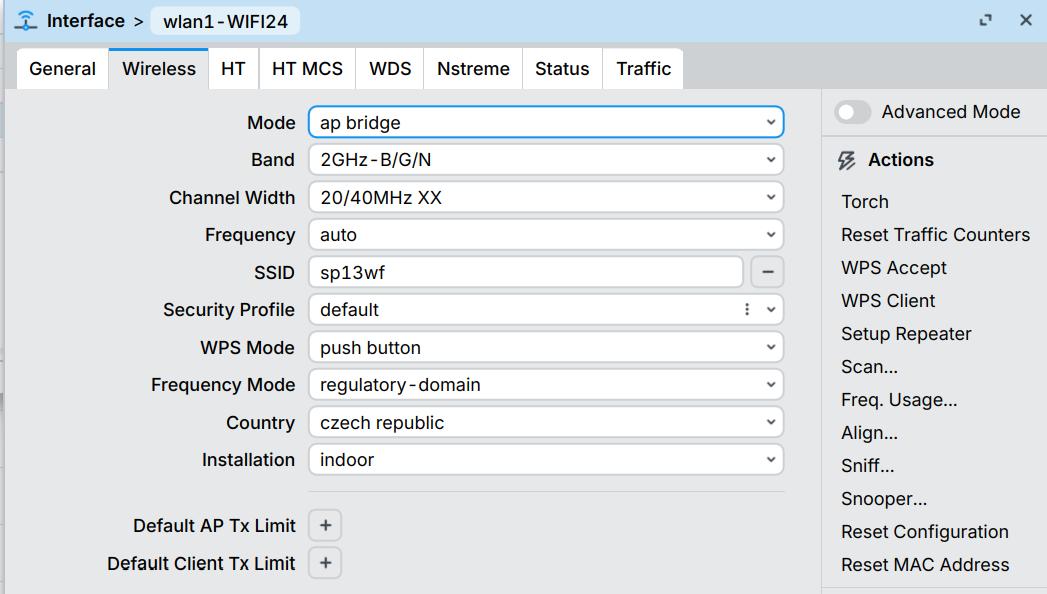

You have an invalid security profile:
/interface wireless
set [ find default-name=wlan2 ] band=5ghz-a/n/ac channel-width=
20/40/80mhz-XXXX country="czech republic" default-forwarding=no distance=
indoors installation=indoor mode=ap-bridge name=wlan2-WIFI5
security-profile=*1 ssid=wifi-doma5g wireless-protocol=802.11
point #21:

The device is an AC3.
It is possible to run on it wifi-qcom-ac (i.e. "wifi" as opposed to "wireless"), it is said that the new drivers are more stable/faster, so - once the issue is solved - you might want to consider using the new drivers.
