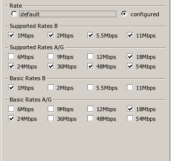

I’ve done the following with both a and n links…
For a- link I disable lower Rates - That way the link wont change from Rates 6,9,18… and only changes between 18 and 36 the CCQ goes 2-3 times
For n-link I disable higher HT MCS t and lower HT MCS - you have to test what works for your link until the CCQ becomes stable at 90-99%
I’m not sure if this is the correct way, but I more than doubled the TP and it’s been stable for 6m now in versions 4.5-4.9
RGDS

The pictures I posted are actually from two different AP’s
  • when setting an -n you can “fool” the system by setting f.e. disable Rate 54
    and f.e. HT MCS 0-6. It will then “jump” to HT-20,40 without having to be able
    to connect reliable to Rate 54.
  • you can play around with this after the link is up. If it is P2P you only have to change
    AP. But if there are multiple stations then you have to comprise the AP
    and finetune the station.
This works for me…
Good Luck with your new Link!
