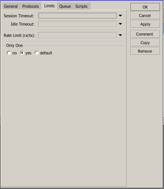

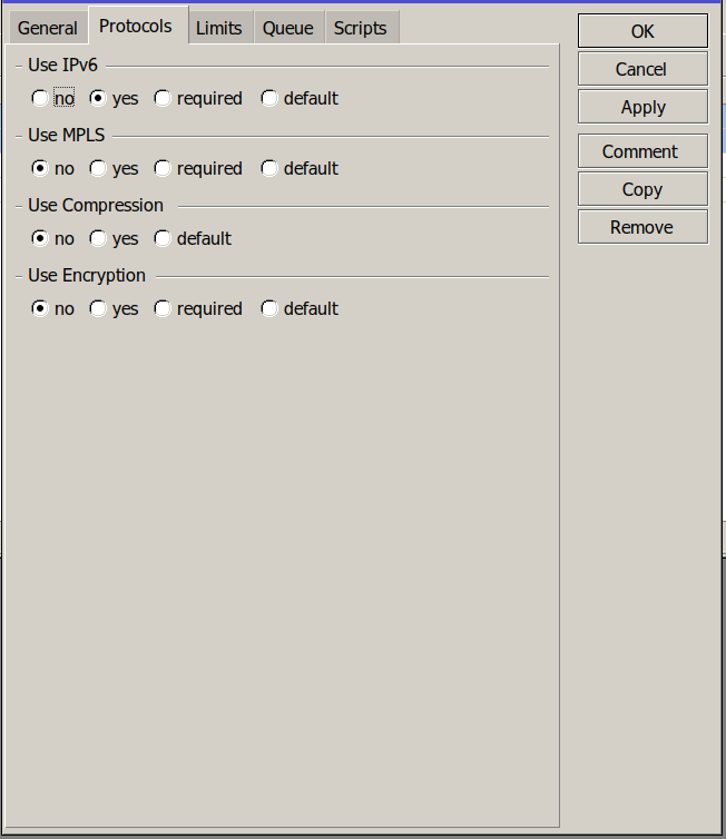

In my case, I have explicitly on my PPP-profile
