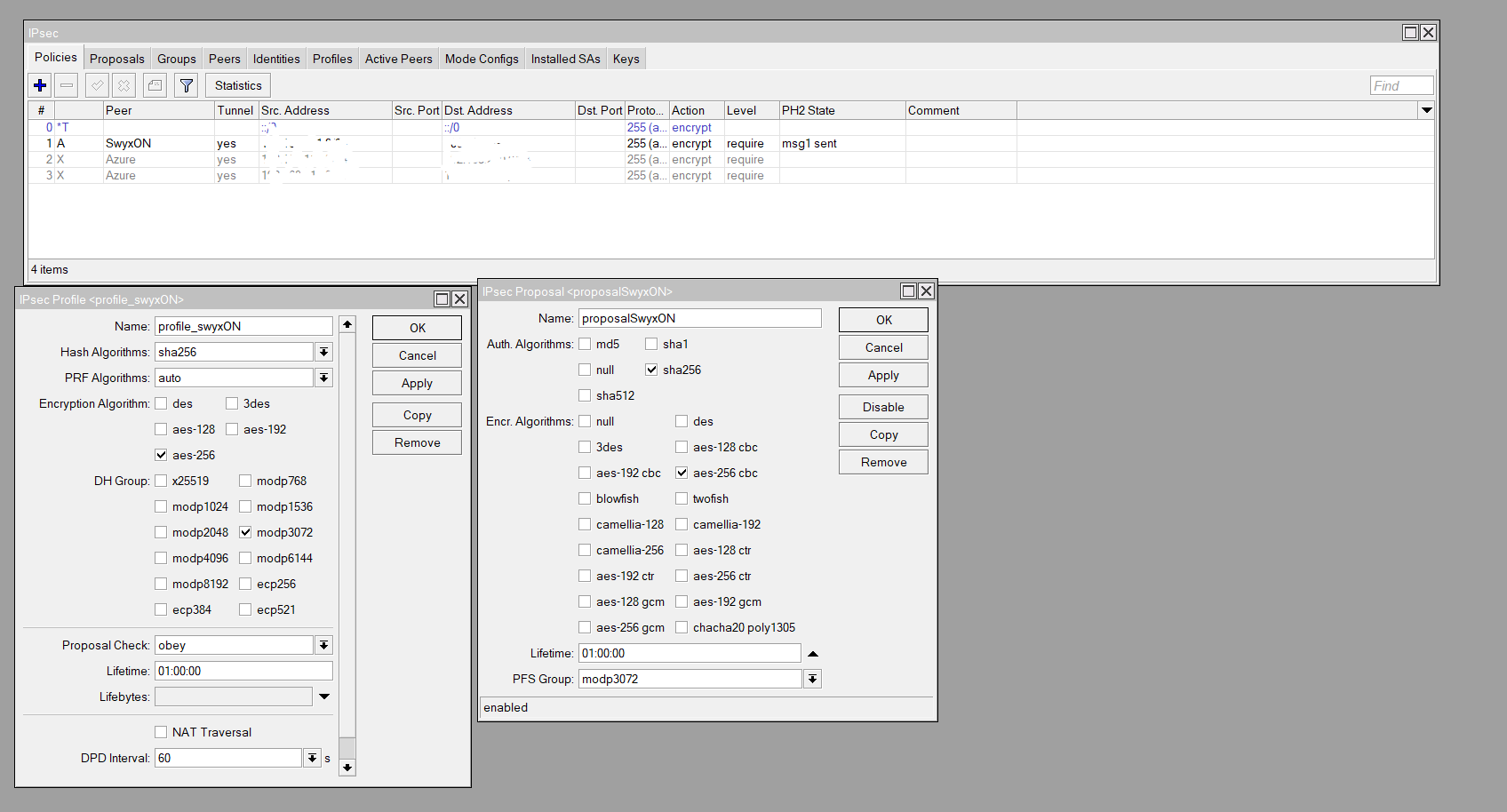

Hello all,

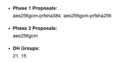

we use a service wich requerer a IPSec VPN. Till recently it worked fine but we have received a message that the IPSec VPN parameters need to be changed and now I am stuck.
The privies configuration look like this
and schuld by changed to this:
I have come this far
With this configuratioen I can see in the Policie, that the PH2 State alternatet between “msg1 send” and “no phase2” the IPSec Log didnt show me an Error Message and I thought that I Must deactivate “aes-256 cbc” in the Proposal but if I try i get this error message
I add the IPSec log (ipsec, debug !package" hear, perhaps someone can find my error.
Change the profile configuration to:
/ip ipsec profile
set [ find name=profile_swyxON ] dh-group=modp3072,ecp521 enc-algorithm=aes256 prf-algorithm=sha256
And the proposal to:
/ip ipsec proposal
set [ find name=proposalSwyxON ] enc-algorithms=aes-256-gcm pfs-group=none
Tahnk you TheCat12,
but is still get the error by thrying to modify the proosal and it seems to be baund on the encryption-algorithm settings.
The ting that puzzled me the most is, tha i can sett every algorithm till aes-256-ctr alone,
but if i try to set a aes gcm or the chch20poly I need to set a second algorithm othern than chch or gcm.
By the way I forgot to mangen its an RB1100AHx4 Dude Edition with RouterOs v7.19.1
Per the following topic it seems that AES-256-GCM has its own auth algorithm and subsequently any other should be removed from the proposal config:
/ip ipsec proposal
set [ find name=proposalSwyxON ] auth-algorithms=""
The only way I am able to only set the aes-256 gcm algorithm seamst to have now Auth Algotithm selected.
I created a new proposal and only set the aes-256 gmc first withaut a authentication algorithm set. If I try to set the auth Algorithm now, even if it is “null”, I get the AEAD error message.
The IPSec tunnel is still stuck in the “no phase” situation.
I would suggest opening a support ticket because this seems like a bug
Almost all uses of AES in GCM mode forego the use of a separate hash algorithm, essentially message authentication is built-in. Therefore providing a hash algorithm when it is used is nonsensical; whether Mikrotik should accept auth=null (or automatically assume it if GCM is used) is an interface question and would at least merit documentation. This might be a legitimate bug, even if only in terms of documentation.
Phase 1 and phase 2 are different. In ikev1 they are very different in terms of their cryptography; in ikev2 they are much more similar. Ikev1 generally doesn’t therefore allow the usage of GCM - at least not in the way it’s usually used. This a fairly good answer:
https://crypto.stackexchange.com/questions/74411/why-cant-aes-gcm-be-used-in-ikev1-phase-1
For ikev2, GCM mode may be used. There are quite a few vendors who don’t (yet?) implement this.
There is no marked benefit of GCM mode for phase1 over CBC mode with at least sha256 hashing.
