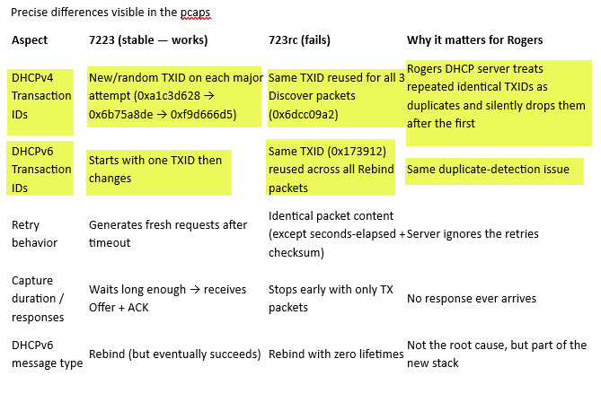

I had a NOC guy look at my situation - where he analyzed my pcap file and looked at the tik logs and he reported the following … sound about right to me
Here’s what changed in 7.23rc2 (and why your internet died):The bridge package completely rewrote how DHCP Option 82 is handled:Old setting add-dhcp-option82 was replaced by new per-bridge settings: dhcp-agent-circuit-id and dhcp-agent-remote-id.
On upgrade, MikroTik automatically migrates your old config.
This can silently change (or stop) the Option 82 data that the router inserts into its DHCP Discover/Request packets sent to the cable modem.
Many cable ISPs use Option 82 (or specific sub-options) to identify/validate the customer router. If the format or presence of Option 82 changed after the upgrade, the ISP’s DHCP server rejects the request → no IP address → no internet. This is the #1 suspect right now.

Thanks for the PCAP summary.

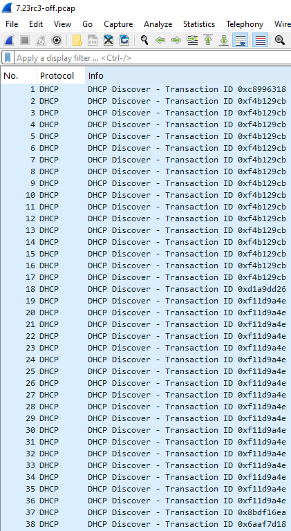

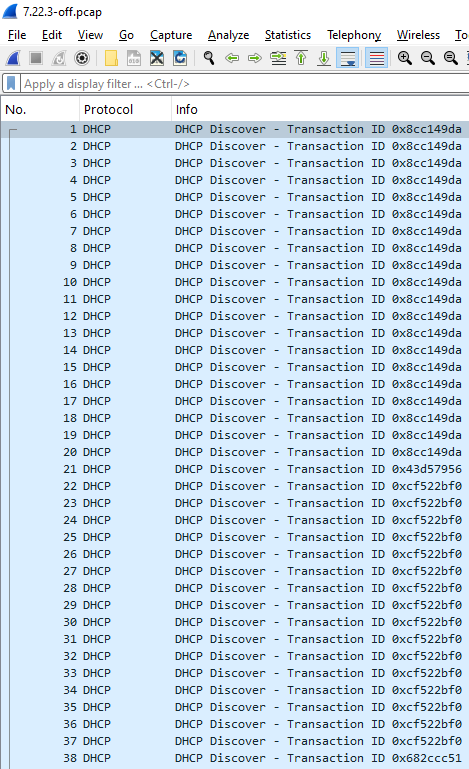

Interestingly, my own observations of the DHCP Discover process differ a bit, in my tests, both 7.22.3 and 7.23rc seem to behave in the same RFC-like manner regarding retries (with the upstream DHCP server turned off/unreachable in order to compare the behaviour highlighted by you).

From RFC 2131 (DHCP), section 4.1:
Selecting a new 'xid' for each retransmission is an implementation decision. A client may choose to reuse the same 'xid' or select a new 'xid' for each retransmitted message.
So nothing wrong here.
From RFC 8415 (DHCPv6), section 16.1:
A client MUST leave the transaction ID unchanged in retransmissions of a message.
So MikroTik is behaving correctly here too if the rebind packets are retransmissions. Reusing Transaction IDs in distinct rebind transactions would be a poor idea.
