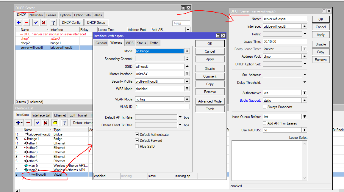

I am learning RouterOS and I am doing some test with a RouterBoard hAP ac lite.
I have created a virtual AP and after that I have created a new bridge and DHCP server.

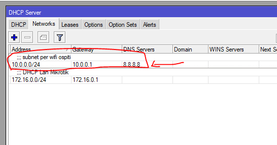

I would that this wifi network of this virtual AP has got a different subnet of the ethernet LAN, in my case “wifi-ospiti” is 10.0.0.0/24 and ethernet LAN is 172.16.0.0./24

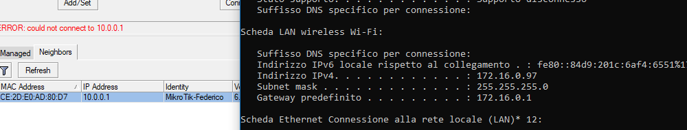

Now it is not working properly becouse when I am connected to the Wifi network ( “wifi-ospiti” ) I receive the same IP subnet of the ethernet..

you have to go to addresses , find the subnet that you created on your dhcp server and that want to use it on your virtual access point and add your virtual access point as interface on this subnet

Yes, I have configured a different address pool for the guest wifi and the subnet is 10.0.0.0/24

It was a test and I tried to follow this way to solve the problem becouse I could not set DHCP server for a Virtual Interface

I have apply some modify to the configuration on my Mikrotik and now the DHCP server is working fine about Virtual AP.
I have attached the configuration.
The way to create DHCP server for virtual interface is:
IP > DHCP Server > DHCP Config > set parameters as IP Network, DNS…
Then I have configured firewall to forward all data from this virtual AP.
Thanks for the help
