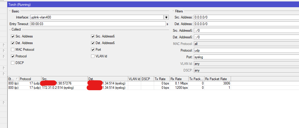

here we watch the package arrive at the door

Torch running on WAN interface

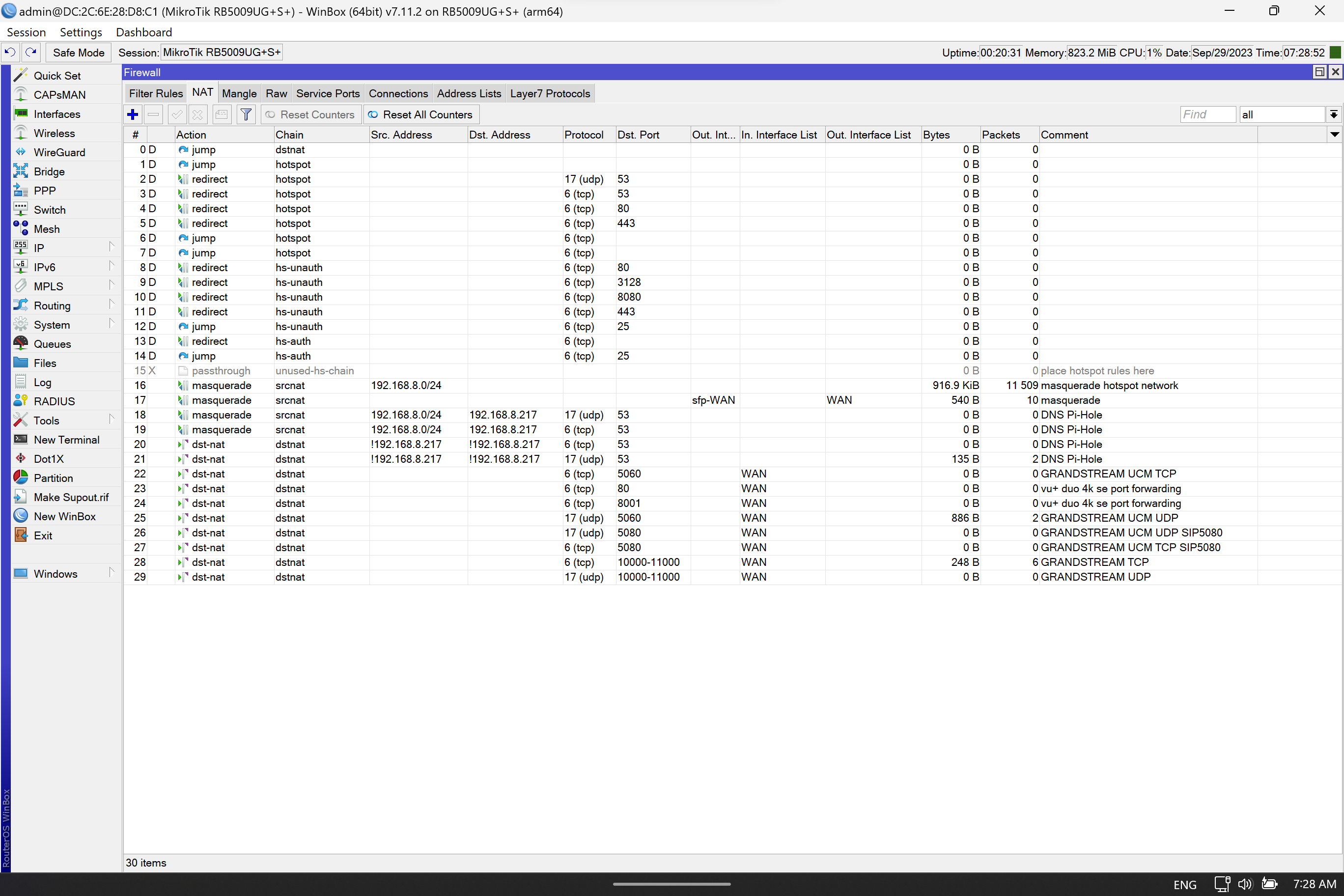

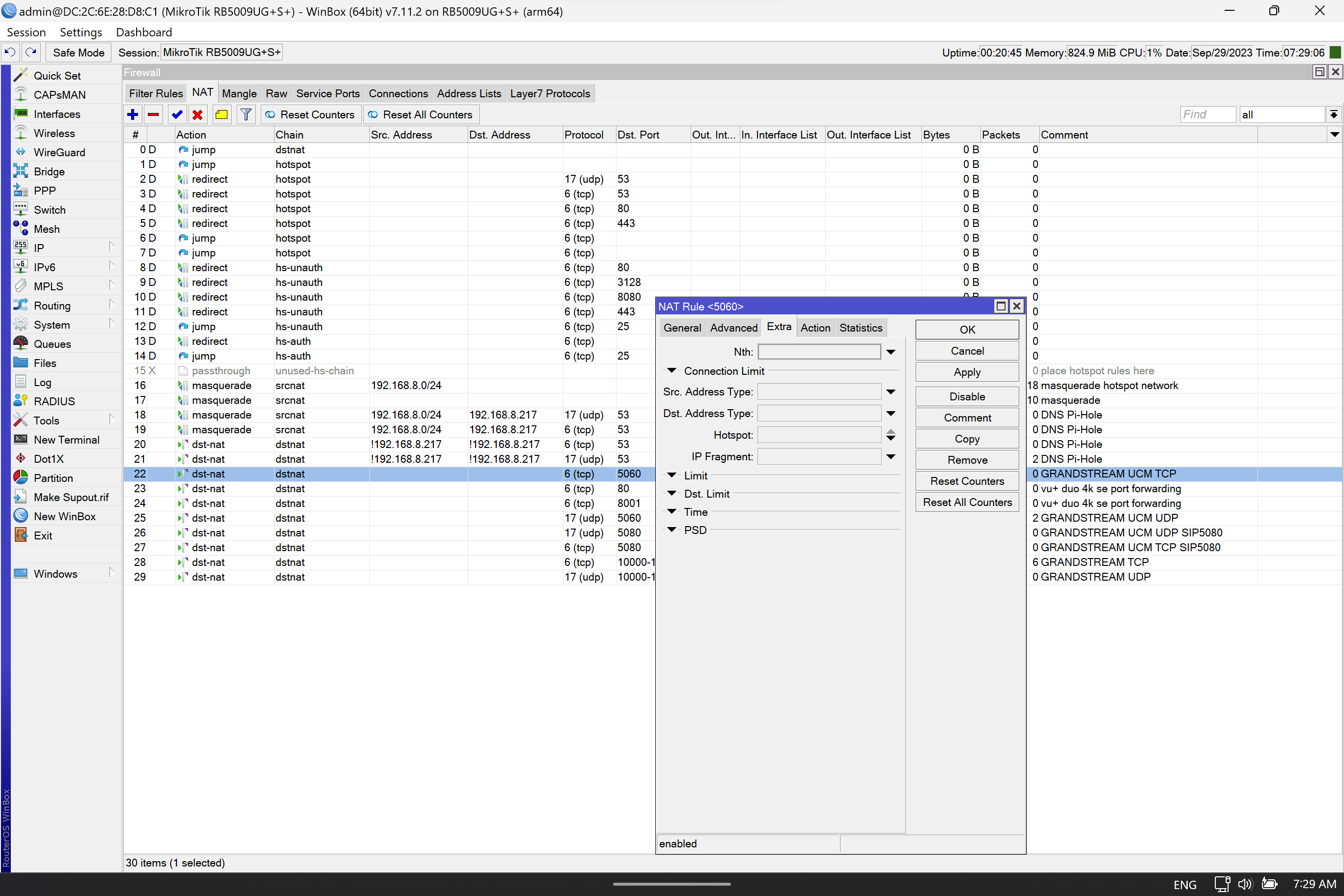

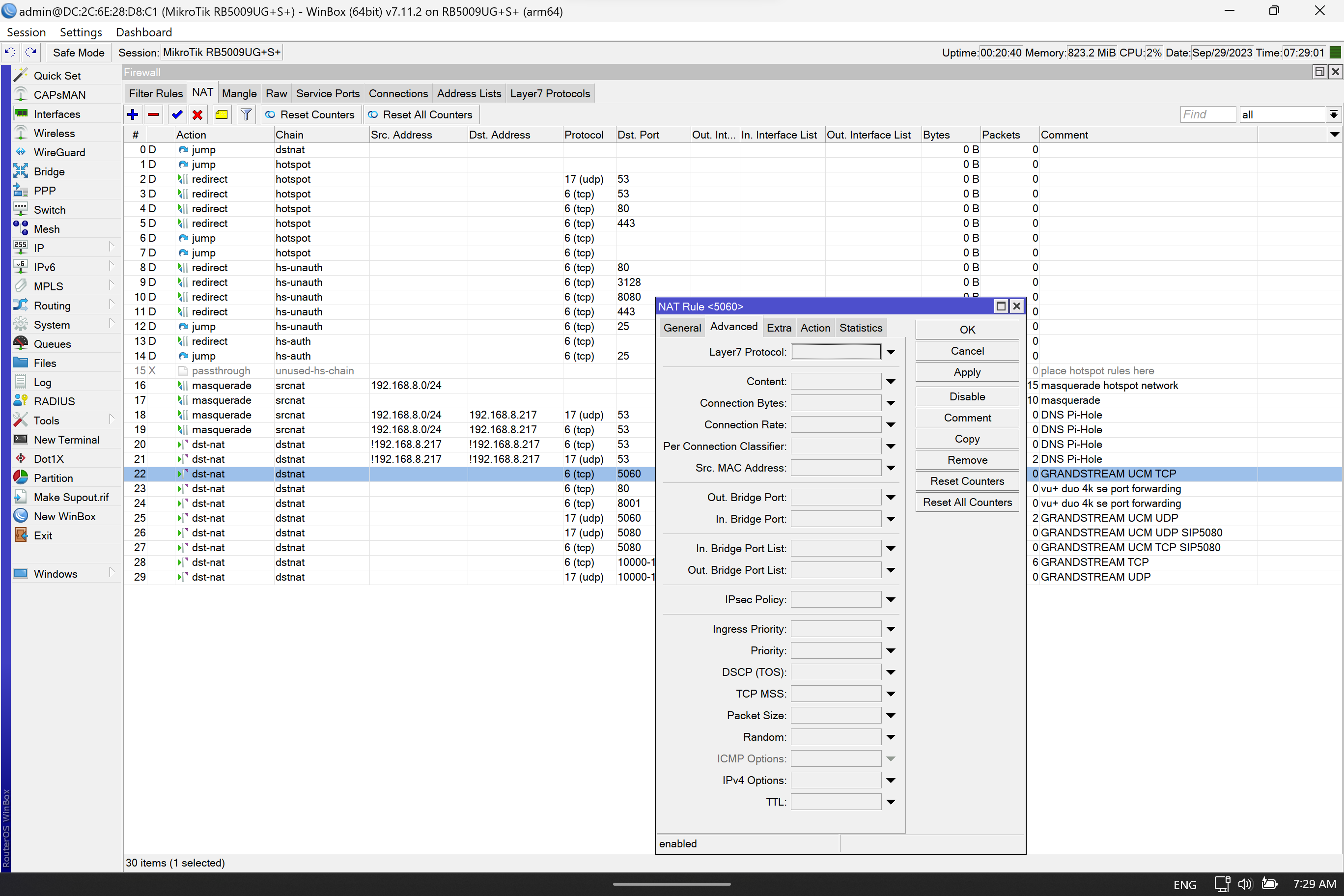

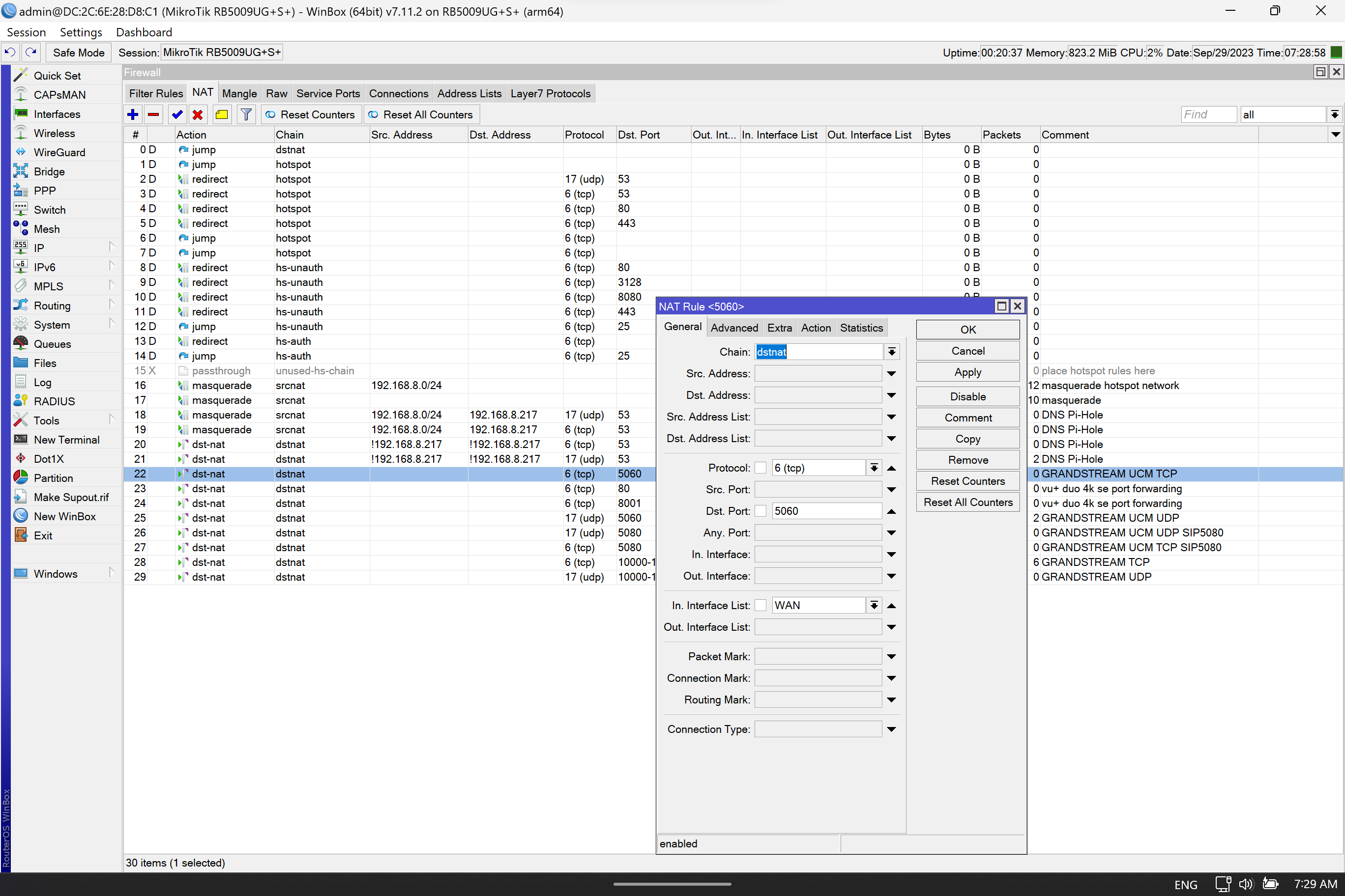

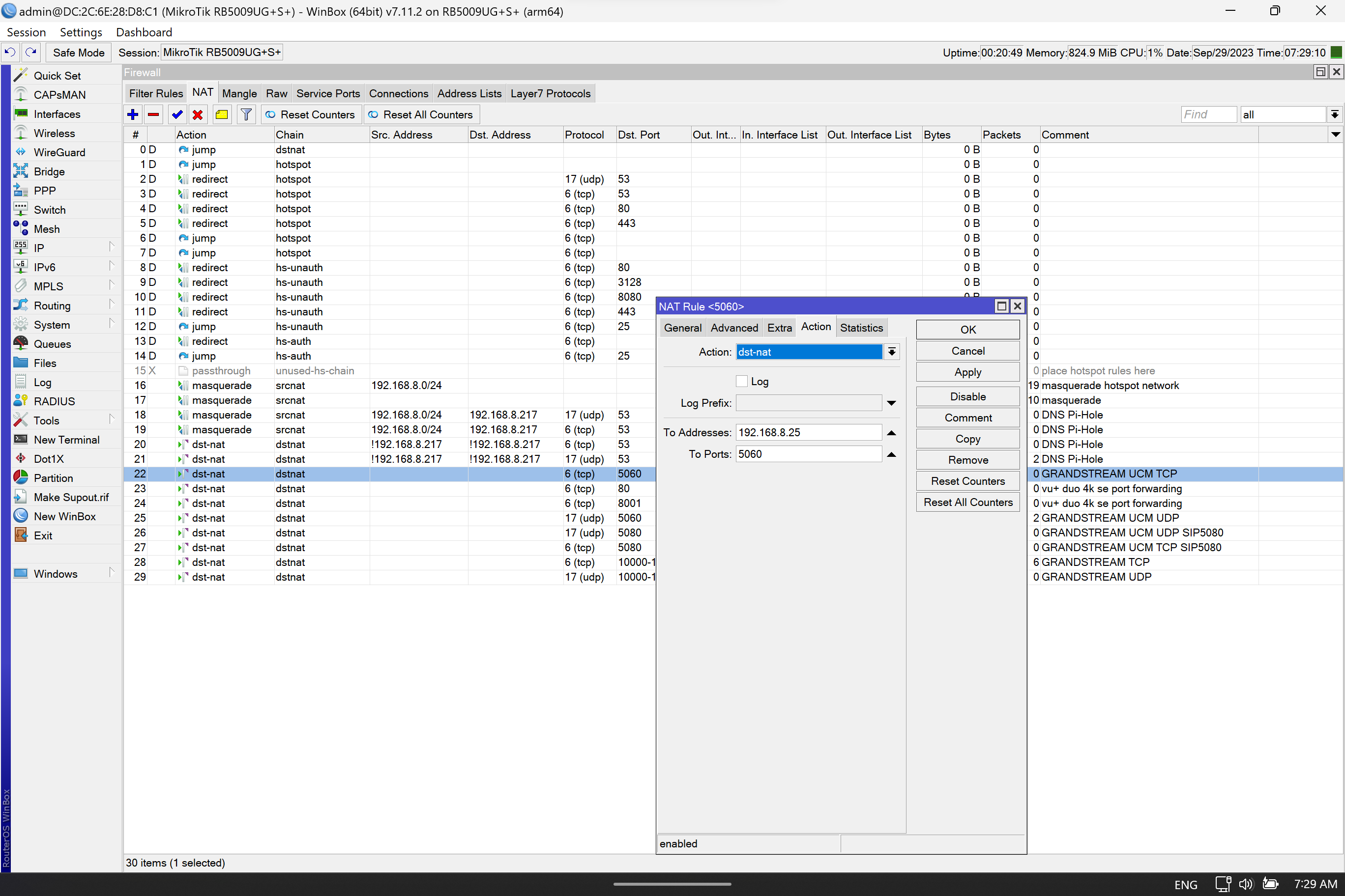

do the seam
note:
my pbx ip is 192.168.8.25
