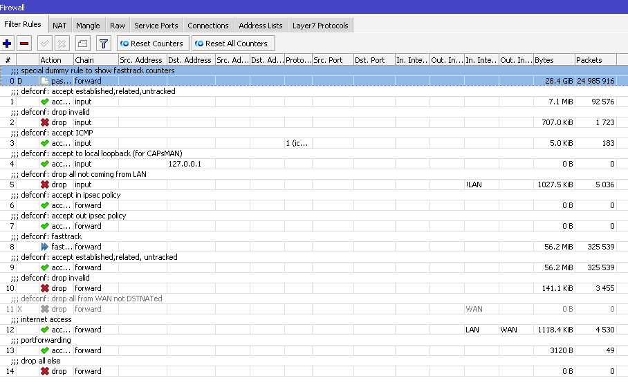

  2. Modify your forward chain rules to be more inclusive of direction of port forwarding so remove old default rule and replace with three better rules that are clearer and block more traffic (better security). As stated you have connections from both internal and external to wan port… thus we accept all dstnat traffic, and this is good.
    ā€œdefconf: drop all from WAN not DSTNATedā€ connection-nat-state=!dstnat
TO:
add action=accept chain=forward comment=ā€œinternet accessā€ in-interface-list=LAN out-interface-list=WAN
add action=accept chain=forward comment=portforwarding" connection-nat-state=dstnat
add action=drop chain=forward comment=ā€œdrop all elseā€

b)
/ip/firewall/filter/
add action=accept chain=forward comment="internet access" in-interface-list=LAN out-interface-list=WAN
add action=accept chain=forward comment=portforwarding connection-nat-state=dstnat
add action=drop chain=forward comment="drop all else"
worked and it seems all is still OK, thanks

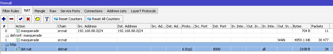

With steps 1 & 2 + changed the NAT Rule In. Inerface List to: ā€œallā€
It works.
I have no idea what I have done, but slowly learning ā€œon the jobā€ :smiley:

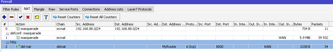

Thanks a lot for all the help!

  1. Modified the NAT rule to:
    and it does not work at all :frowning:
    nor outside (like it used to) nor inside (fake loopback)
  2. Changing back to ā€œALLā€ - everything works fine
Thats weird, okay I must have overlooked something…

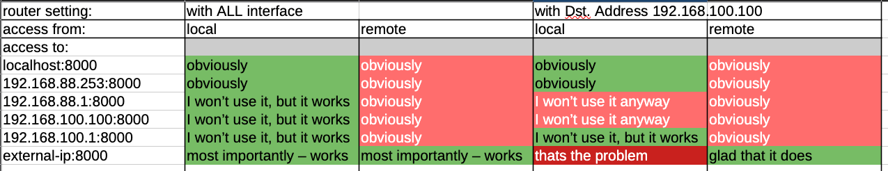

Well, 192.168.88.1:8000 i could live without.
I just compared it, as with ā€œALLā€ it works even with that.
But unfortunately, specifying 192.168.100.100 it does not work with the external IP (if I am inside the network), so the loopback does not work :frowning:.

Because your Port Forwarding rule is incorrect. You still have the in-interface part in there, should be removed.
From:
add action=dst-nat chain=dstnat comment=http dst-address=192.168.100.100
dst-port=8000 in-interface-list=all protocol=tcp to-addresses=
192.168.88.253
What do you mean by specifying the external IP?
DO you mean LAN users put 192.168.100.100:8000 and it doesnt work ??
Can you confirm external users can put the DYNDNS name of your public IP and it works.
URL:8000 ??
Hi.
Sorry, my bad.
I actually noticed that issue as well, but I must have exported the config before removing ā€œin-interface-list=allā€
Anyways, answering your question
Do you mean LAN users put 192.168.100.100:8000 and it doesnt work ??
URL:8000 ??
I think there is extra confusion because of my double-NAT situation, the problem is that so far ā€œin-interface-list=allā€ is working exactly like I’d like it to…
Maybe I should contact Mikrotik if they see any issue with that setup? Not sure how to approach it.
I will sum up the whole thing with a table, which will I think explain best my requirements and the situation:

Your last firewall filter is dropping all forwards including LAN to LAN. The previous rule is allowing LAN out WAN so your internet still works, but the loopback is LAN to LAN.
Ok, I understand… But I guess I lack knowledge how to fix that.
All the beginner sources:
Seem to propose what @Mesquite mentioned, but that’s not really what works best in my case.
You can remove the last 2 rules as the default drop/dst-nat rule performs most of the same purpose.
Or narrow the scope of that last drop rule by adding src-address=192.168.88.0/24
I have changed the NAT rule to, like in the tutorials, Dst. Address to 192.168.100.100, removed ALL from In Interface List
And I have applied both your suggestions (separately)
  1. Added src-address=192.168.88.0/24 to the last filter rule
Still the external-ip:8000, requested from the internal network does not provide any response
  1. Disabled the two last rules
No difference. Basically for both cases the above table with colors still apply.

In terms of rules, you need a basic firewall rule allowing port forwarding
add chain=forward action=accept connection-nat-state=dstnat comment=ā€œport fowardingā€
You need a hairpin nat source nat rule in case you want internal users to be able to access the server by the WANIP or DNS name.
