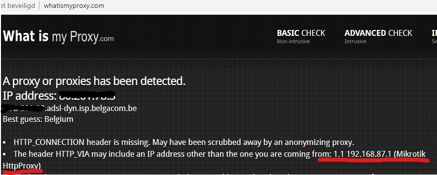

How can I disable proxy on mikrotik? I have problem to access on some pages because i have block from WAF .
When I check proxy status by for example on whatismyip.com/proxy-check or ip-check.net/detect-proxy.php so I see there Proxy detected.
Web proxy I have disable on mikrotik.
Our buisness ISP says on their side is everything ok. They say problem must be on your side.
Virus or similar you think on MikroTik? How can I analyze it?

If your active web-proxy is the Mikrotik, you should be able to see that. (I use this proxy without caching for a much improved HTTP management session for TP-Link through an SSTP tunnel over satellite)
for me, the most important thing is to find out if there is a problem. On my side or on the side of the ISP when they claim that the problem is not on their side
What I see on your screen is that the IP mentioned (is it yours?) is in the list of the “bad guys”, like there are many blacklists for spamming or open mail servers, that list can be checked before you accept the mail.
If it is your IP address, then you will have to get your address removed from that IP2Location PUB proxy black list. (For an open mail server I know you can initiate the “open mail server” test yourselves, and if you pass the test (not open anymore) your address is removed from the list. I don’t know if such a check can be done here (https://www.ip2location.com/database/ip2proxy) )
If it is not the address you get from the ISP, check if you are using VPN, Proxy or Tor, or some other anonymizer technique in your network. The IP address shown will be that used by the VPN, Proxy or TOR service!
If it is not the address you get from the ISP, then this can also be a shared address with other ISP clients (ISP doing CGNAT) and some of those other clients are using a system this Proxy-detection-bot is looking for. (Happens quite often with other blacklists, eg where your website is shared with others. Other blacklist just block a whole subnet or DNS subnet instead of just one address).
In case 1 and 2 you have to take action either against the IP2Proxy blacklist, or removing the offending service
In case 3 you might be the victim of other clients doing things that are detected by this checking bot. I’m afraid only the ISP can move you away from the offending clients.
