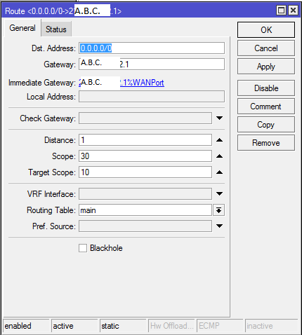

In work I've Chateau LTE12. LTE is backup connection. I've script which check main ISP and if it failover LTE starts - it works until 7 Aug when upgrade firmware from 7.20 or 7.21 (I don't remember) to 7.23. At 7 Aug people from my work phoned to me, that they cannot work remotely (via plink). I restarted router and still don't work, change main ISP to LTE and script change to main (main works OK). Quick reading on internet - Ros has CVE and ... we had "security breach", ssh not work because someone change who can access via ssh (172.xxx, 10.xxx and 196.xxx). Removed this and now they can work remotely. I upgraded firmware to 7.23.x stable, this upgrade flagged router. Script no fully working because status is flagged or something else changed with upgrade?

WANPort is port where main ISP. I testing more ping then 4 because sometimes first 4 is OK and rest not.
BackupISP (comment=Zapasowy) is LTE.
Until upgrade script work OK, after if ISP is LTE this /ping $adrHost interface=$WANPort count=20] always return 0.
