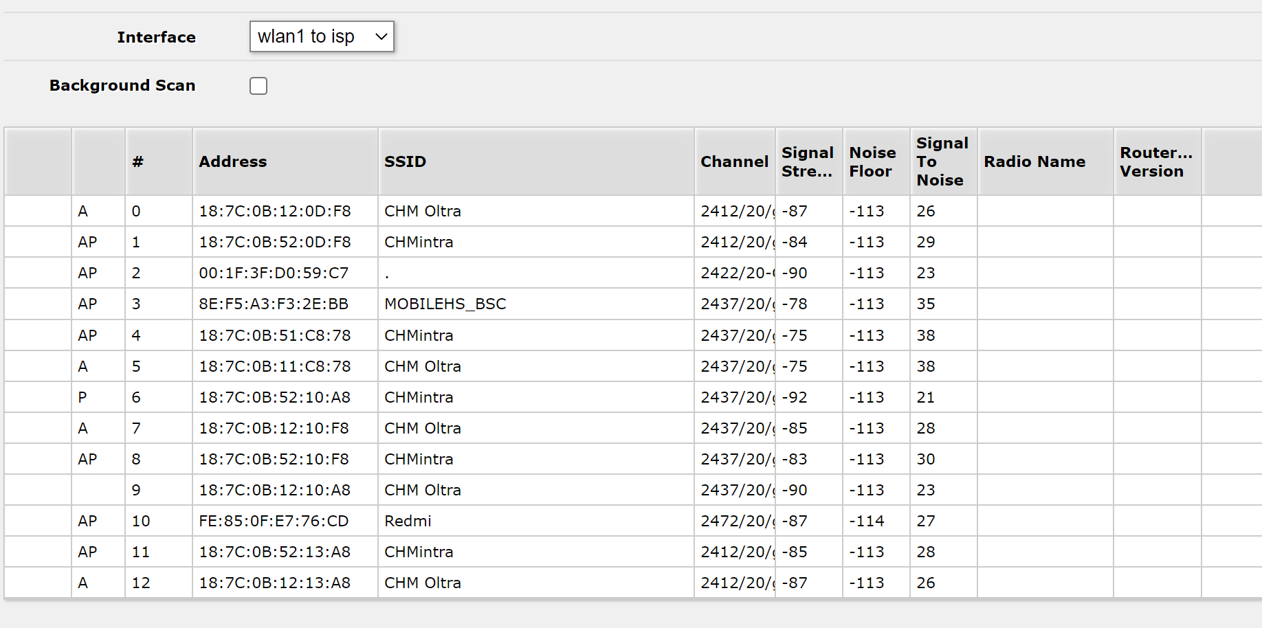

in the appendix is a screenshot of my scan. I try to connect to CHM OLTRA.
I thought that a connection using EAP with given username and password should do the job, but no. I can connect to the network, but no traffic goes through.
