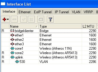

See the attached picture. Does that help?
Thanks both for trying to help out.
It helps! I presume that the hotspot is assigned to the bridge bridgelienter. Which interfaces are assigned to that interface? How is the ip/subnet assigned?
The two hotspots will be assigned to sone1 and sone2. These are the two wireless zones we have.
The 530 is the VLAN (our uplink) where we are connected to the world of internet.

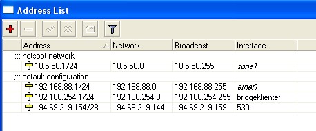

Here is the picture of ip address
What physical interfaces are assigned to the bridge? If there aren’t any physical interfaces assigned to a bridge it will not work.
I see that there is already an IP assigned to sone1, so if you are trying to add the same IP address again, that’s where the error is coming from. Try deleting it and going through the setup again.

I removed the IP assignement for the hotspot network in the Adress List and tried to run the wizard again.
This time I get to the last step and get the following error message:
setup failed to add ip pool: pool with such name exist
So where do I start looking now?
After playing around with the system I saw that the ether1 was having the same network addresses as I was trying to assign to the hotspot. I’m not sure what ether1 is or if it is just a default interface that can be deleted.
Well anyhow I tried one more time now setting the network pool to 192.168.89.1/24 instead and now the wizard went the whole way and no error messages.
