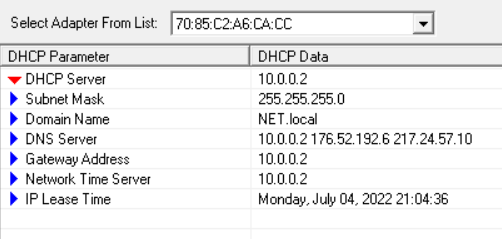

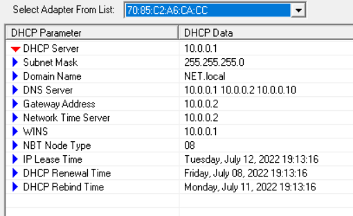

This is very awful. I’ve checked with “DHCP Explorer” what Informations are sent through Windows Server DHCP and MikroTik DHCP:
DHCP Windows Server:
DHCP MikroTik DHCP Server
I only see differences for DHCP renewal time and rebind time. It isn’t mentioned with MikroTik DHCP. Could this be a Problem?
What is the difference of MikroTik an Windows DHCP that can cause sucha Problem.
