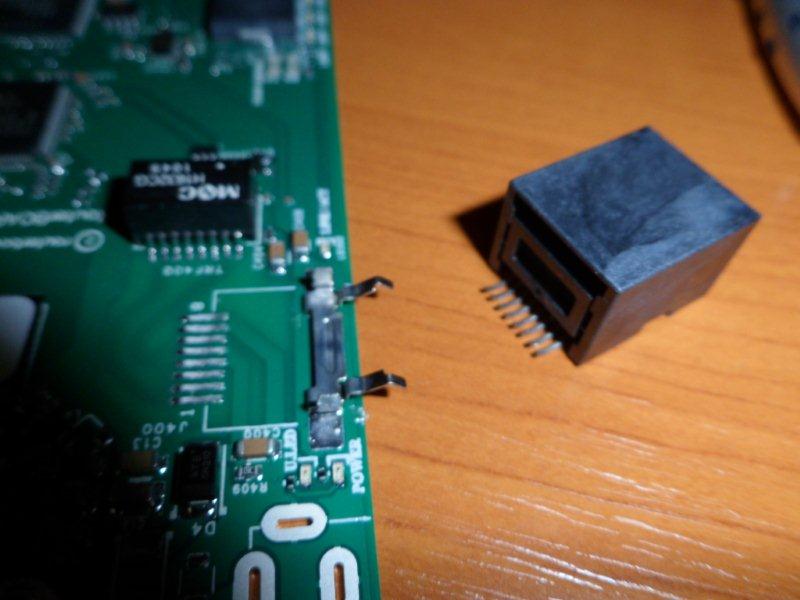

Try to think about this new RB711…What was the problem with old shield connector??? This new RB are…ehm
what did you do to it, to break it off?

Ethernet port is really impractical solved. The cable must to trigger bottom which usually can not. Two plastic ethernet has dropped me. Although they can be soldered back but the warranty is over
Right!
Some encluseres like the Mikrobox, Poynting etc pull on the connector when closing the lid. Therefore it would be nice to
have the old shielded connector that has better support to the board.
The plastic connector doesn’t look good in the Mikrotik CA enclosures
+1
