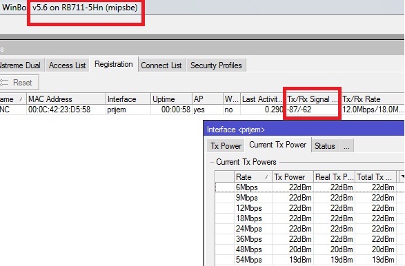

There is a change from the factoryon the board. The first picture shows a defective serie

The picture in second post. See… Tx is default 22dB and in registration is very bad TX signal. This works most of the new rb711

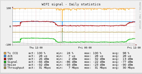

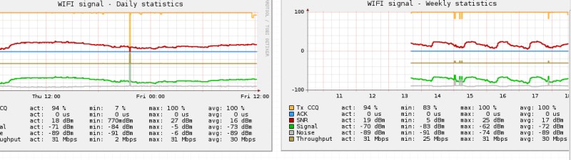

Bellow are graphs of two RBs associated on different AP on different locations faraway oneself.
For comparison, bellow is graph of temeretures on GROOVE in our area (district).
