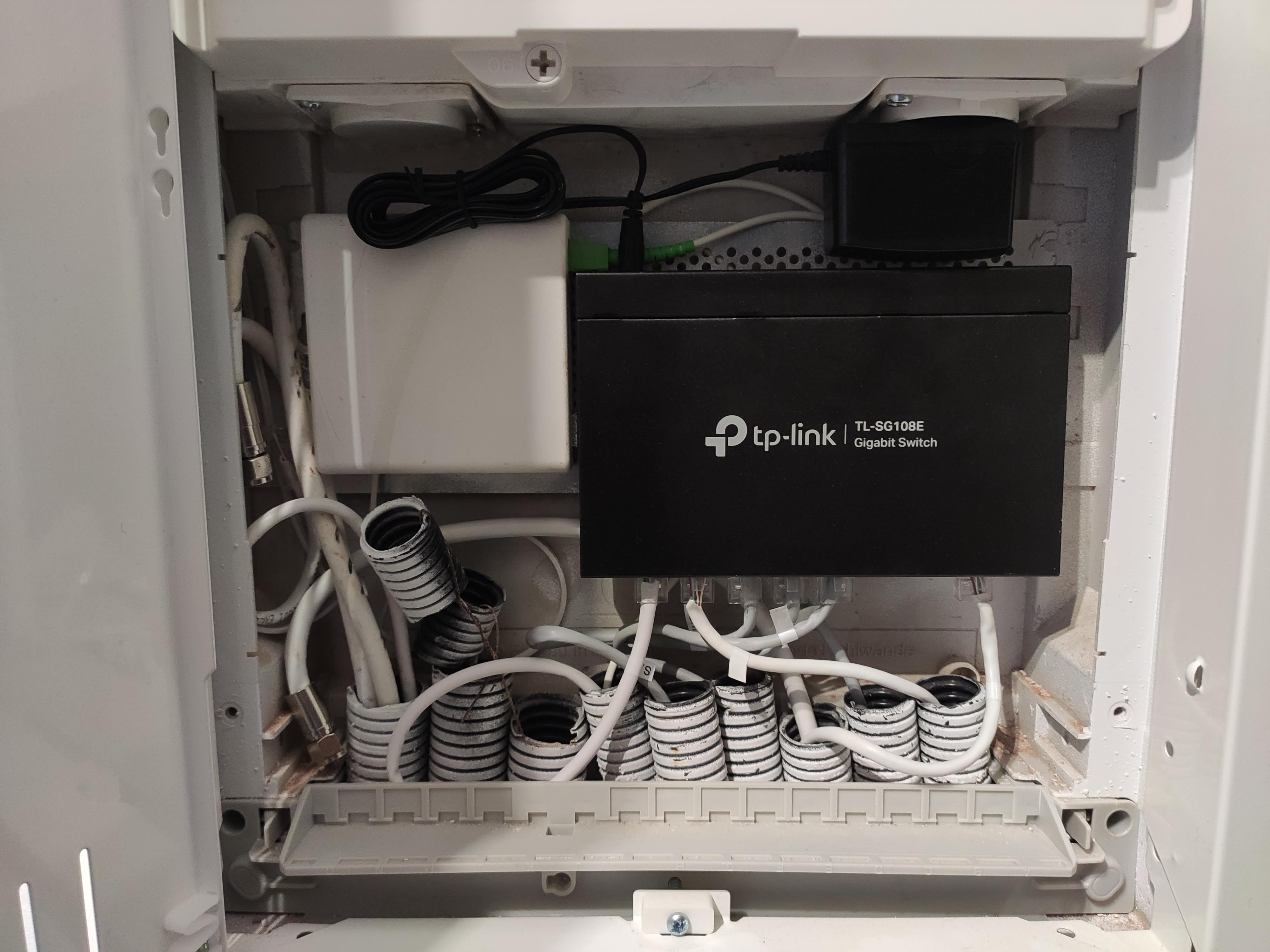

Recently I was looking for a gigabit switch to expand my home network. I only had limited space in my junction box which had all Ethernet cables routed into and could only fit single device in it.
Fiber goes from junction box to another room where I keep my router (hAP ac^2), AP (TP-Link AX1500) and switch provided by ISP. Main trunk cable comes back to junction box where it connects as an uplink for the main switch. Then all other rooms get their Ethernet from main switch. Because of constraint space this topology is only possible solution for my home network and it is very common in all modern blocks of flats, at least in Poland.
Finally I ended up buying TP-Link TL-SG108E. This was only solution that fits the space, has 8 GbE ports and supports 802.1q. It has it downsides though. It lacks any open protocol for remote configuration/monitoring, only custom solution I found is this psmode/essstat and it simply scrapes the html of web GUI. Also it has plenty security issues like lack of HTTPS and authorization session checks only IP address of the client.

Since you’re in the Mikrotik forums, I’d suggest the RB5009: https://mikrotik.com/product/rb5009ug_s_in
The only issue is it runs an odd version, v7.0, right now but that’s purportedly stable for these devices. With hardware offloading, you’d have switch-like performance, but option to be a router.

Just saying when I look at the photo and read the subject line (and put a Mikrotik hat on)… this screams like a use case for the RB5009. May not work here, but a ruler would know… See the RB5009 is 22cm thick, so it might be able to mount behind (or in front) of the white square unit in upper left of the photo. But yeah at 220mm wide, that may not be just a “drop in” replacement.
The question is does someone care if a device is labels as a “switch” or “router”? Since “Bridging” specs of the RB5009 is pretty close to the “Switching” specs of the CRS112, does it even matter? See RB5009 tests between 3Gb/s to 9+Gb/s, depending on packet size – maybe not even that much available bandwidth upstream. If PoE was needed, this IDF seems to have power, so a DC y-spliter and PoE injector(s) might work. Plus, having a common OS between the router and IDF “switch” is a plus in my book for maintenance/support/updates/etc. And, if one got creative, VRRP could be used to make the RB5009 in the flat’s IDF a backup router if the upstream router rebooted/updated/broke.
