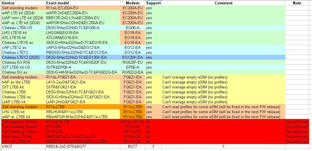

There is a list of this modems from MikroTik
These modems do not have eSIM built in. Requires an external eSIM chip. For example, a physical eSIM card (eSIM in a standard SIM form factor).
https://help.mikrotik.com/docs/spaces/ROS/pages/30146563/LTE#LTE-ModemeSIMmanagementsupporttable
Ok :slight_smile: , the Mikrotik list completed with device name and model and (cleverly?) coloured (how it should have been made).
The LTAP mini and the KNOT don’t have an evident way to check the modem model or it is not present in Mikroptik’s original table, if anyone know, please post the info and I will update my table.
EDIT: Attachments updated with the info from ortazebra and optio (thanks). The modem in the Knot remains “unclassified” at the moment.
esim_modems.xls (17.5 KB)
LTAP mini lte kit (2024) - EC200A-EU
LTAP mini lte kit - R11e-LTE
R11e-LTE6 is also used in HAP AC3 LTE6 KIT
Chateau LTE12 (RBD53G-5HacD2HnD-TC&EG12-EA) has EG12-EA, also should be supported.
There is cAP LTE12 ax duplicate row, maybe is meant to be instead one of them.
