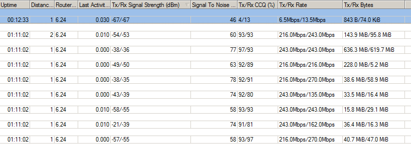

Occasionally i have really bad speed on my entire network.
I have come down to that one of my clients (RB911G-5HPnD) is the problem.
It opperates at 6.5 Mbps and my whole network does the same.
If i remove it from the access list everything work perfect.
Is it really possible that one client can take down the overall network speed for the other clients?

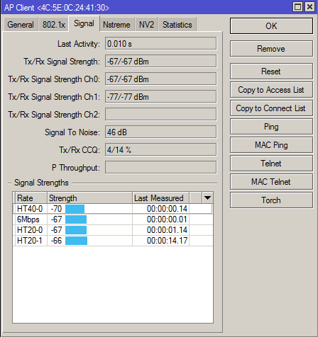

The bad client seems to have serious issues with interference and also the 11dB difference between CH0 and CH1 is suspicious. Is this SXT or 911? Might be too far for the antenna used, you may want to use better antenna to keep the signal similar to other clients.
This client uses all airtime when passes data, therefore performance of whole AP gets bad. Apparently this is happening even NV2 is using TDMA. Thats why we need some kind of airtime priority to be able to limit bad clients.

This is a 911. I found out the client had a bad placement.

Well, when you are building the network you need to make sure your clients are properly installed, aimed and that they all have similar signal strength. Do not allow such a bad client to connect to the AP, low CCQ and low signal is the values you are looking for.

Access list and minimum signal strength is a good thing but sometimes the signal could be OK but bad CCQ because of interference. In this case the client will still be connected to your AP because will have good signal but performance would be bad because of bad CCQ…
