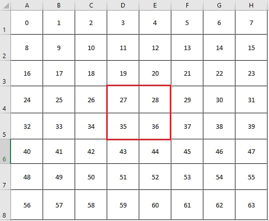

When adjusting ptp 60 GHz, you need to block the tx-sector in the central part (sector 27,28,35,36).
Example (Master and Slave)

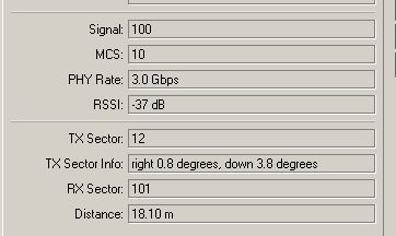

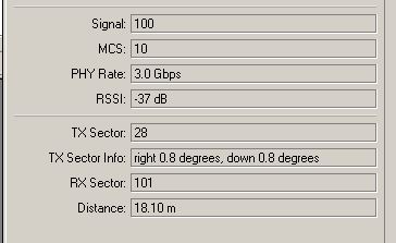

Here’s what I got
Master
Slave

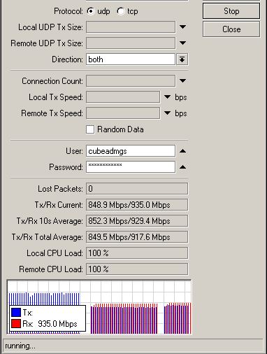

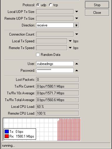

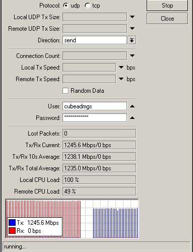

Bandwidth Test PtP 60 GHz (CubeG-5ac60ay)
