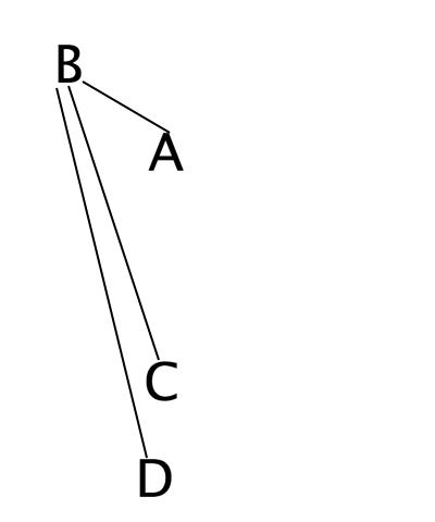

We are moving closer to setting up some links in Ireland and just wanted some more advice.
We have Base A which has 1Gbps fibre link.
We want to send 100Mbps to 150Mbps to Highsite B which is about 4.5km away
Then send connectivity to Home C 16km from Highsite B and Home D 21km from Highsite B, both are within 20 degrees of each other when sighted from Highsite B as shown in the very basic drawing :manhappy:
We want as much speed as possibly at the homes but ideally close to 50 Mbps true tcp speeds. LOS looks good for all sites with possibly 2 trees to remove near Home D.
I was looking at UBNT kit with two nanobeams M5 400 for the link from Base A to Highsite B then Rocket M with 90 sector and Rockets at both homes or is using a sector at 21km going to be too weak and do we need two PTP links to the homes which would leave us with 3 devices at Highsite B?
But I’m led to believe I can achieve better results with Mikrotik gear?
Any advice welcome

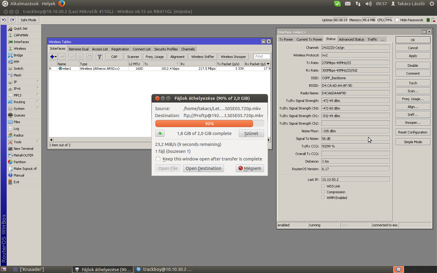

Hello, i made a test again, this is my best result so far.
Test equipment: RB 951, RB 750GL, RB 411GL
On my Ubuntu 12.04 running a Proftp server, so this speed is TCP.
On all RB running OSPF. Between RB 951 and RB 411GL there is 2.4 Ghz connection at the moment.
I just wanted to show you that devices capable of what you are looking for.
