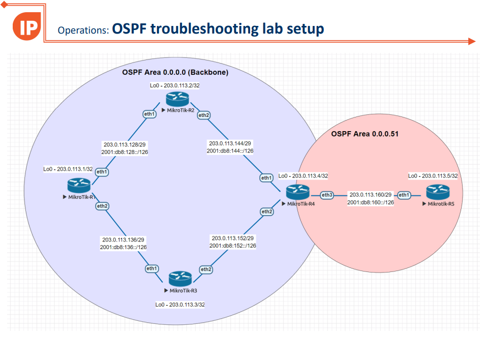

If you want a single public IP on each tower, the easiest thing to do is create a loopback using a public IP and then advertise it in OSPF. That way you can keep using non-public IPs for the subnets that connect the towers.
Even though this presentation I did is on OSPF troubleshooting, you can see the design using public loopbacks in this drawing.
https://mum.mikrotik.com/presentations/US18/presentation_5296_1523892575.pdf
