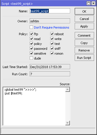

":put" problem in scripting
Unable to use :put to display contents of global var from within script.
Terminal cli works fine and can see that global var is changed from script, just no output on console
when initiated from script.
Using 6.43.7 and latest Winbox.
Have searched forum and google for answer without success.
Suggestions appreciated.
This is normal behavior. If you want the script to print output while it runs, use the :log command which will output to the system log.
:put outputs in current session, but since the script is run in separate thread with it’s own environment, the output won’t be visible.
If you were to call on it from a shell you have open, it will output: “/system script run script1”
Another option: use :log
