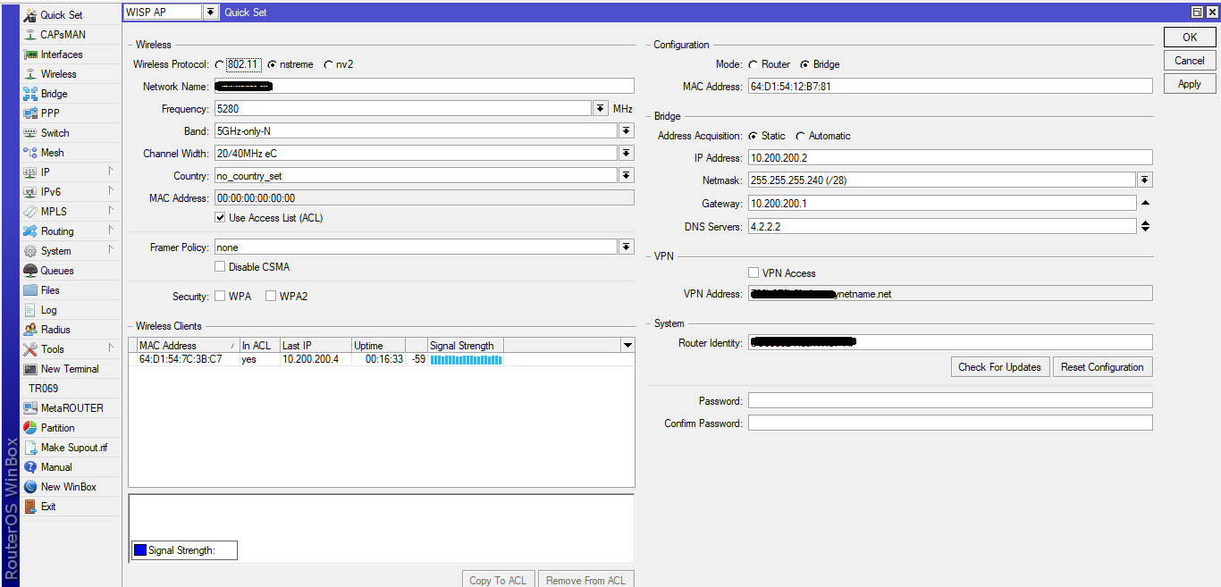

I setup a PTP link using QRT5 over 5km for 155Mbps
I cant however go beyond 75Mbps Day and 100mbps Night (Bandwidth between AP and Station)
I have changed between Frequencies, Channel width and protocol
This is the best so far
Below is my config
Some thinks from my side:
Add Security to this link by enabling WPA2
Set your Country, until this is not done you are possible sending in bands you are not allowed to, and with too much power.
For Channel checking on 802.11an Devices you can also use Spektral scan.

But 155 Mbit Netto TCP are not possible with this devices!

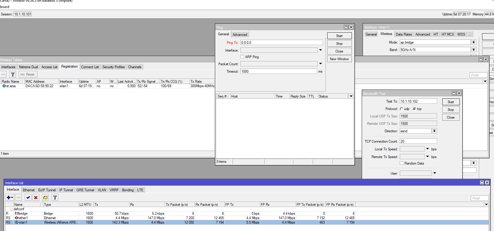

up to 180mbps with 911G at 11km
The thing is if you test between boards, ~75mbps is what you get.
@Innox
Make a screenshot and use iperf for testing
InoX
April 4, 2018, 9:06pm
10
Here you go 11km link between 911 with 30dbi antennas and test between router and wireless station .
No hardware for iperf. Happy now?
