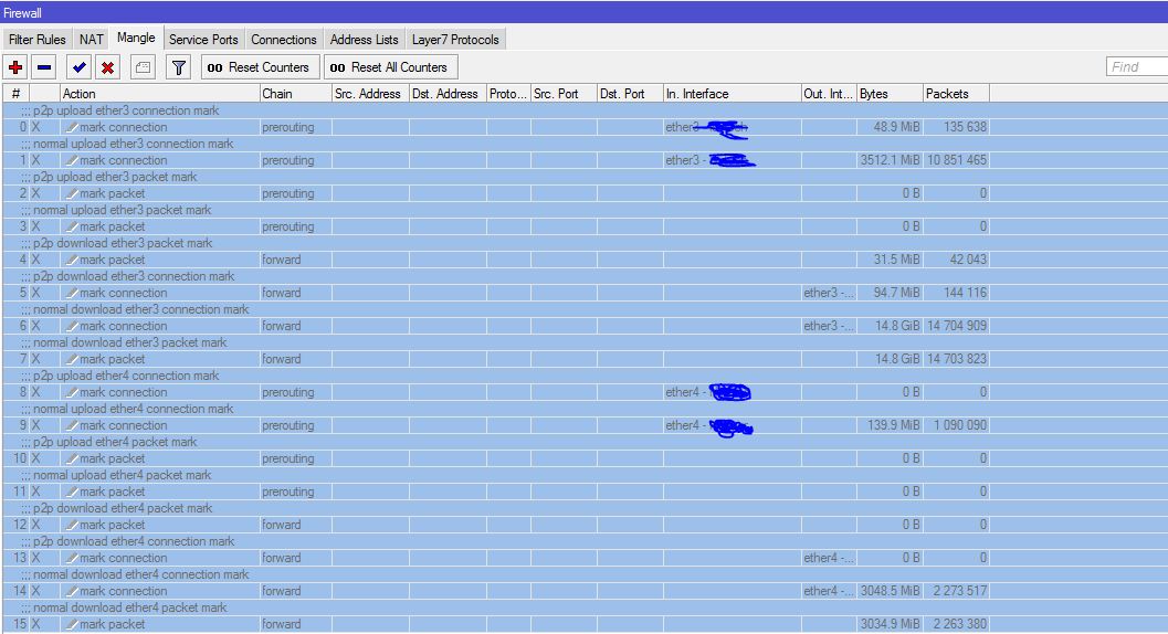

I have setup some mangle rules to mark packets, specifically P2P packets.
We plan to implement some more packet marking to mark VoIP packets to give them higher priority. Not sure yet how to do this. Any input on this greatly appreciated.
I am attaching a picture of my mangle rules with good descriptions. Assuming everything that you cant see is right, are these in the right order to get the desired reaction?
Hi. About P2P, you need to look into this topic http://forum.mikrotik.com/t/how-block-connection-of-p2p/18495/1 About VoIP (SIP), I guess you need to catch RTP packets. So L7 filter is better to mark SIP RTP packets http://l7-filter.sourceforge.net/protocols

I understand. If you can mark P2P traffics successful, you can do any action block or set priority. I believe you can find solution from the topic, which I posted.
