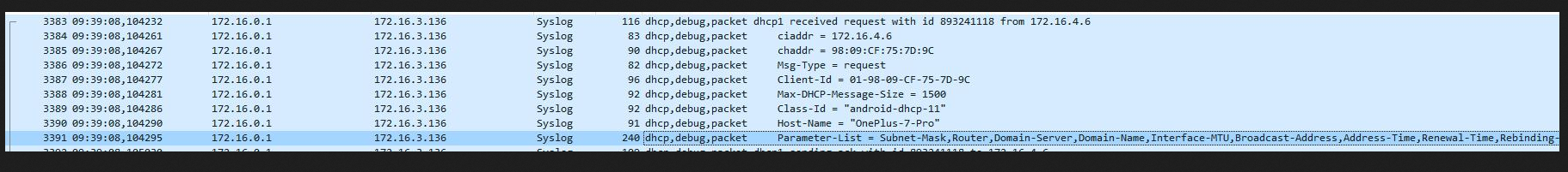

I used this script and i did get some messages into my syslog. Question is if its possible to export info from DHCP lease into 1 message instead of multiple messages? (see attachment)
You enabled debug logging for DHCP, is has nothing to do with the script you quoted
So would it be possible to get in log info from DHCP lease with active hostname? (as is written in 1st post of this thread? thanks
Sure, you even quoted it: http://forum.mikrotik.com/t/question-about-dhcp-log-new-feature-request/64400/3
