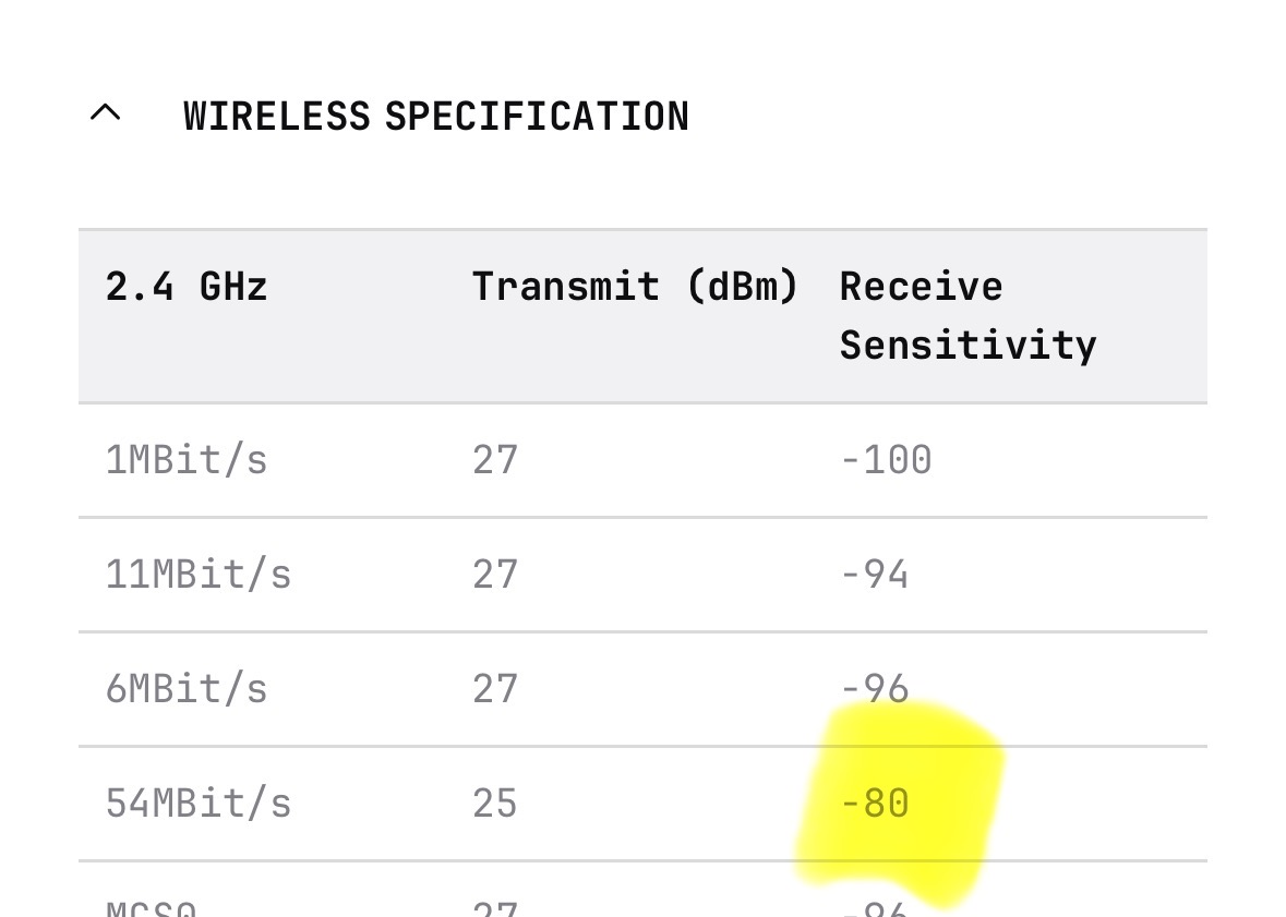

I wonder how it’s possible that a 4dBi antenna can have the same Receive Sensitivity than a 12dBi antenna.
In my understanding (which seems to be wrong), a higher gain antenna should have a better sensitivity (assuming they have similar rf input amplifiers - which might be wrong but probably not to a 8dBm extent - and even, the mAntBox should have a better input amplifier if any different).

They both have same figures here :
Could someone explain to me how to read this « wireless specifications » section ?

Receive sensitivity data reflects not so much the efficiency of the antenna, but rather depends on the receiver's internal low-noise amplifier.
The measurement technique itself (requiring a stable signal sufficient for data transmission) assumes that the received signal level is significantly higher than the receiver's minimum sensitivity threshold.

That is exactly the point : it seems weird to me that the internal low-noise amplifier of an entry-level product brings 8dB more gain than a high-end pro-grade device’s internal amplifier.

As for the noted WiFi data, I think it is given to show some basic compliance with standards, rather than the real performance/sensitivity.

Rx sensitivity data is about WiFi chip. Also signal strengths will be reported as levels on chip entry, it doesn't take antenna gain into account.
A strong signal, received with a side of antenna (where gain is likely negative), will translate into similarly decent signal as a weaker signal received with center of antenna (with highest gain), measured (and hopefully used) by Rx part of WiFi chip.
Yes that’s also what the Mikrotik support kindly answered : “Receive Sensitivty” is the Wifi chip alone (without antenna). Now things are crystal clear.
