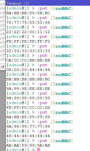

Thank you very much for your sample code~It’s just V7. If [: rndnum] and [: rndstr] can be downloaded and used in V6, it would be very convenient! But I think it’s unlikely~
Thank you, [rextended] God! But there are quite a few duplicate bytes in the generated MAC, and there is a high probability of 22:22:22:22:22, 66:66:66:66:66, AA: AA: AA: AA, EE: EE: EE: EE: EE: EE. I have an idea that if we could generate a random number of 0-15 and retrieve each half byte from the specified string using [: pick], would this type of duplicate byte be even fewer? Is the generated MAC also more realistic?
You use the script on x86 or CHR?
There is no random number generator on v6, and using an extremely fast CPU produces the same number.
I add one artificious delay on previous sript (please remove quoted scripts on your post) that apparently on my CHR/x86 fix the problem (and work on both v6 and v7)
