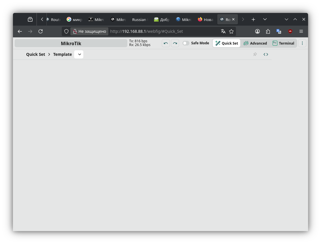

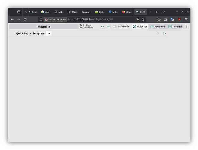

Hello everyone. I have hAP ac2, RouterOS v7.20.4. Everything works, but the quick settings are missing. Resetting the configuration doesn't help. How can I fix it?
Thanks.
Hi and welcome.
Everything related to Webfig (which includes Quickset) is known to be a problem in 7.20.4.
Try to use Winbox or downgrade to 7.20.2 (or even 7.19.4).
