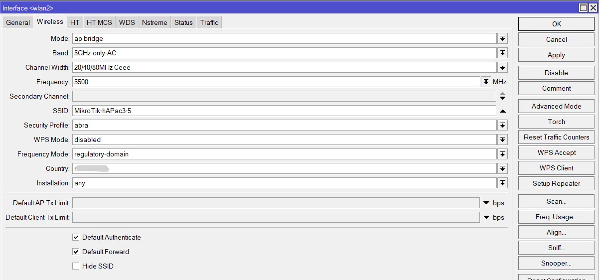

  1. Fill in the wireless interface WLANx in Wireless,
    TAB “Wireless”. Mode is “AP bridge”
    fill in (same or different SSID but same security profile as the WLAN that is already operational)
    Frequency mode and Country the same as the other wireless interface

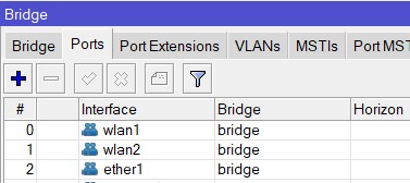

  2. Add that WLANx interface (x is 1 or 2) to the bridge ports.
    Menu … Bridge … tab “ports” … use “+” to add port … select the missing WLAN interface as interface and the existing bridge as bridge

I got everything working great based upon your step-by-step instructions.
