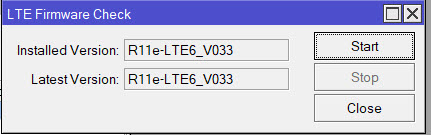

the same that appear when you check on your devices
/interface lte firmware-upgrade lte1
no devices.
R11e-LTE - v020
R11e-LTE6 - v033
