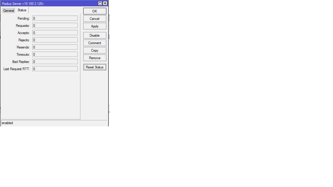

I can attach the nat rules as well if you think it would shed some light. My apologies on the late reply.Radius reset stats attached. No mangle but src-nat, dst-nat and masquerade are all being used. I don’t believe the requests are being natted and if they were the source “should” appear as the locally attached interface to the radius server and thus the responses “again should” be directed back towards that interface in ever circumstance. L3 is pointed at this interface as the default gateway and L2 should be a GARP/arp away from success but not so. I’m not convinced I have a good handle on the NAT in Mikrotik. I come Cisco Land and it appears to function a bit differently. After several failed attempts at authenticating the counters remain at zero. Not sure if the refresh for that is on a cron or real time. Please advise, thanks so much!

because the router is not sending any radius requests (0 Requests).
These stats are close to real time, if the router were using radius for login auth you’ll see the Requests counter increasing; if there were any problem contacting the radius server, both Resends and Timeouts counters would increase too.

If that were the only cause, Rejects should have counters increasing.
First goal is seeing Requests counter is increasing, i.e., ROS is using radius for login auth, which doesn’t seem to be the case right now.
Once the Requests counter increases, if as you pointed out, Rejects starts increasing, it will mean exactly that: src-address needs to be checked.
