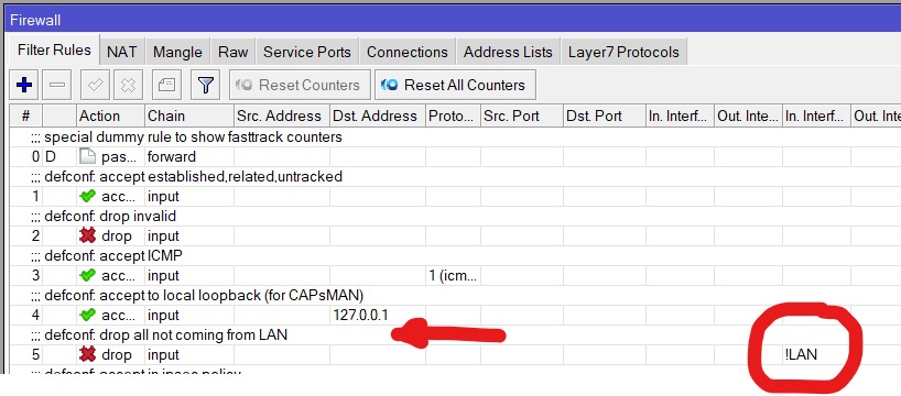

Just check your firewall for the rule that is blocking (drop) in the input chain.
For the default config it probably is the rule to drop input from every interface (or bridge) that is not in the LAN interface list.
So possibilities are
-) add explicit rule for UDP port 1812 that accepts input, and comes before that drop rule in the firewall
-) add interface or the bridge the interface is port of, to the “LAN” interface list
FW rules for input are limited by SRC IP address(-range), interface, interface list, UDP/TCP protocol, port number , or to any other filter you place in the rule.
The first rule that matches the filter is used.

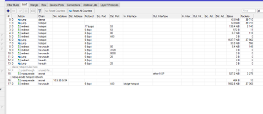

In my case, at first i added LAN interface masquerade in Firewall/NAT without source network. For hotspot network , source network is add in NAT. Result is "Radius server is not responding.
I tried to add port 1812 in firewall but still not responding.
After adding source address in masquerade of LAN interface, radius server is working perfectly.

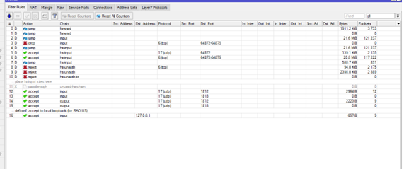

Don’t forget to check firewall filter, if following is needed.
add action=accept chain=input comment="defconf: accept to local loopback (for RADIUS)" dst-address=127.0.0.1

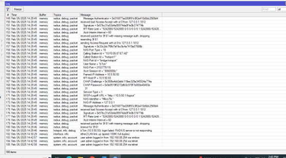

Enable system logging topics “radius,packet,debug” and “manager”, to see what happens.

mine not working, it stil has the radius server not responding
please refer to this image sir.. thank you very much, hoping for your response
