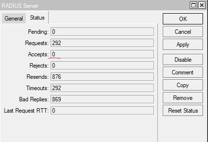

I have the same issue with the Hotspot using Radius on 7.15.
I’ve confirmed via Wireshark that ‘Access-Accept’ packets are being received by the Mikrotik, yet the ‘Accepts’ on the Mikrotik shows 0 (and the Hotspot doesn’t auth users).

Mikrotik Radius Server Status says :
Requests : 1
Accept : 1
Timeout : 4 !!
Bad replies : 10 !!
All other items : 0
Downgrade step by step from 7.15.3 to 7.14.3 and OpenVPN connections work again.
Requests : 2
Accept : 2
Timeout : 0
Bad replies : 0
All other items : 0
